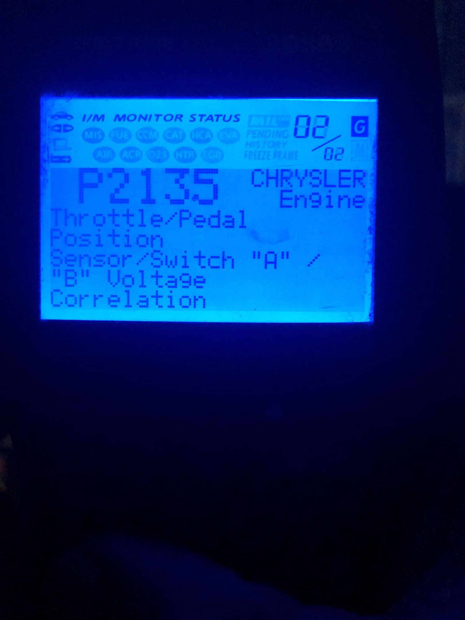

Codes
P0221
P2135
They still appear after changing Throttle Pedal and Throttle Body from Dealer. Also Changed Ignition Pack, Spark Plug wires and plugs. 2 years ago I changed the PCM ECU, Alternator, battery and battery terminals. there is no help on the internet for this problem.
Need help ASAP.
