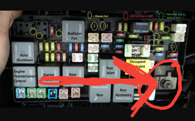

My Jeep has been deadlines the last few weeks. I'm not sure what the problem is, I do think that I am not getting enough power to my starter. I took a very short vid of the engine trying to turn over but not succeeding. However, I do not think that I can post vids here so that's out the window. I have replaced the starter, the battery is good, I've gone as far as hooking up my other car to help jump it but still the same thing. Any help is welcome.
Did you get a chance to check the power cable going to the fuse box near the battery? This is where the cable attaches. I couldn't tell by looking at the cable. Had to physically move it while the ignition was on
