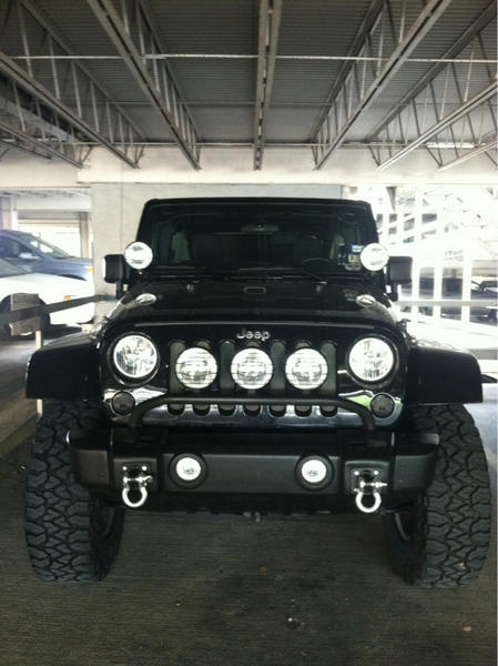

CosmicWrangler's Avatar
Posts: 149
From: Houston texas
Remove bumper w 8 bolts. Remove tow hooks. Cut crash cans. Reinstall bumper. Bolt on d rings w stainless steel hardware from Lowes. I found stainless d-rings at a flea market in Alabama when wife and I were heading to Florida. I painted bumpers and added VDP bumper ends.

Originally Posted by CosmicWrangler
Attachment 402248
Your bumper turned our sweet!
