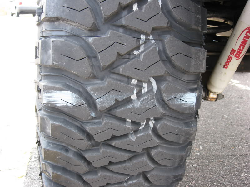

Try this.
  1. Cool tires
  2. Flat surface
  3. Rub sidewalk chalk in a straight line all the way across the tread
  4. Drive a short distance in a straight line
  5. Examine remaining chalk
  6. Over-inflation is indicated if the center section of the chalk is rubbed away and you're left with chalk remaining nearer the edges of the tread face (see example photo below).
FWIW
