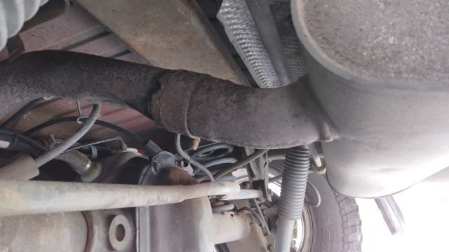

I have an exhaust leak where the Muffler connects to the tail pipe. You can see where exhaust leaks out turning the pipe black. I'm going to tackle this by first replacing the clamp. Anyone ever have this problem and wound up replacing the muffler and tail pipe.
Tail pipe and exhaust
tail pipe and exhaust clamp close up.

I thought about Muffler shops. Looking at the exhaust system it's mostly all clamps and a easy design until it splits to both sides of the engine. Now here's my better scenario of getting this fixed. By having a new clamp gives me a chance to remove the muffler and clean things up and try to figure out why it's leaking to begin with. That's why I'm asking if anyone has ever gone this route before.

After seeing some videos on the subject got my curiosity and I started cleaning the area with a wire brush. The muffler/pipe is almost separated from corrosion. I put some of that high heat epoxy on the crack and I'm very surprised how strong that stuff is.
