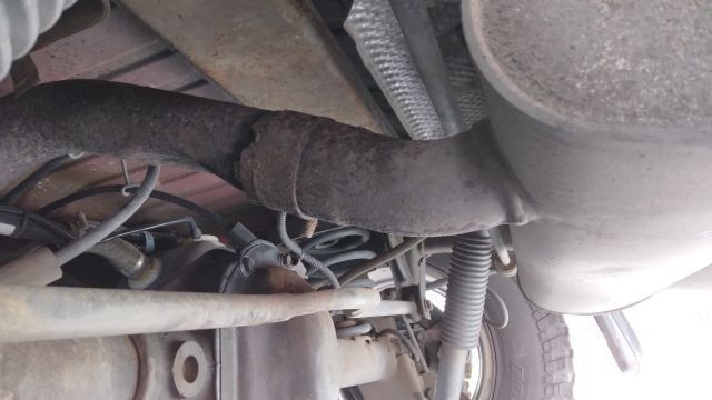

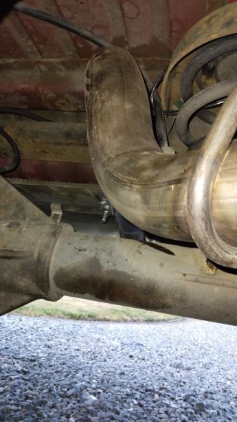

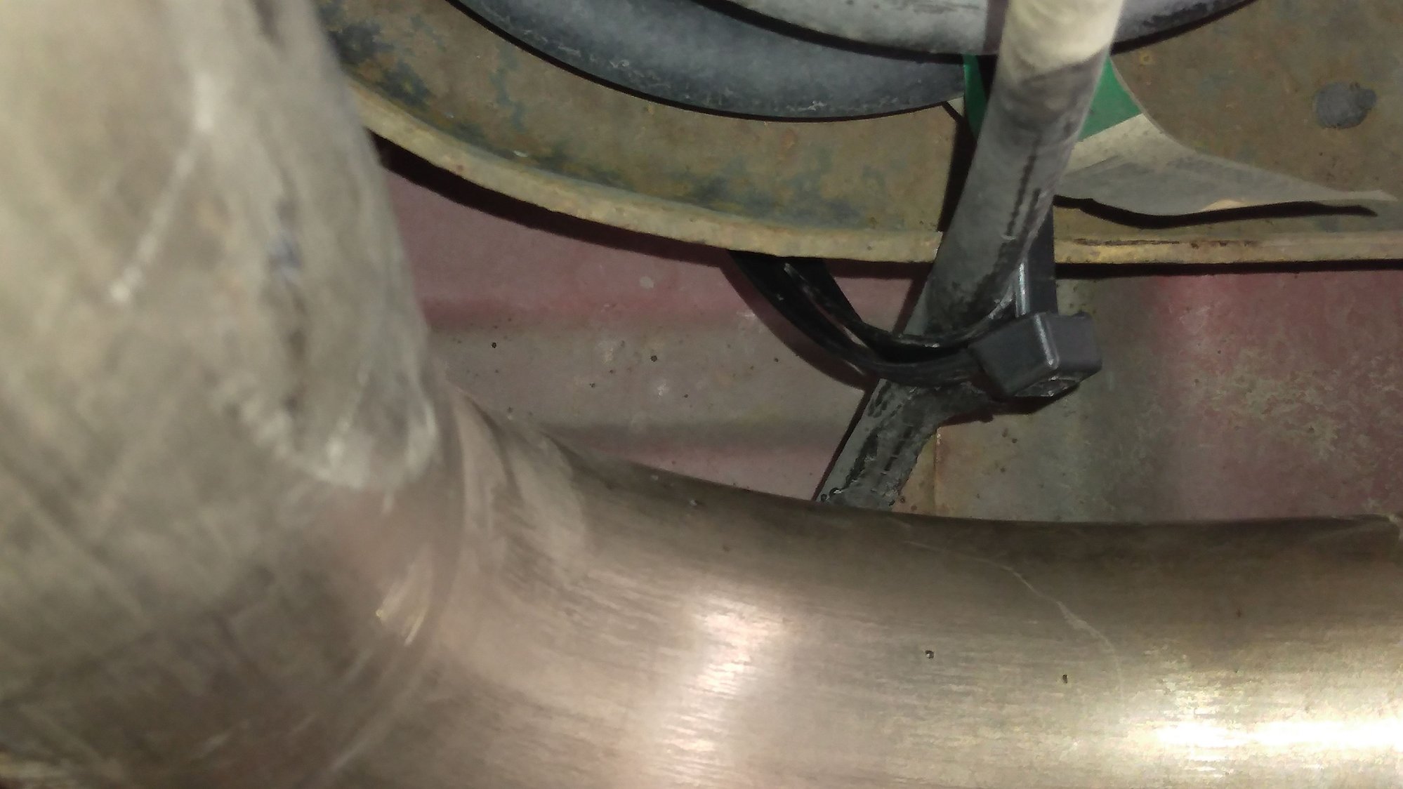

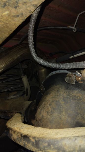

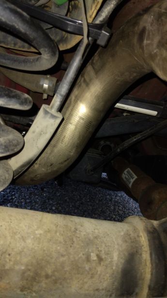

Provided Before and After Pictures of Parking Brake. Installed by Dealership. Parking brake cable wrong side of pipe and burned. Pay attention to the cable routing on the before and after pics. These parking cables are only available online maybe thru Ebay. Which means they have to do a Technical Directive and replace both left, right cables and the Parking lever. Don't comment about Dealership. I looked around and they we're my best option. This sucks! Manager going to be freaking!

Shouldn't a burned cable be replaced?
