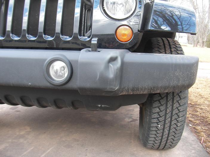

i bumped into a little post and it pushed in the section to the right of the right fog light. How abouts do i pull off the front cover to try and push it back out from behind?

Any help..

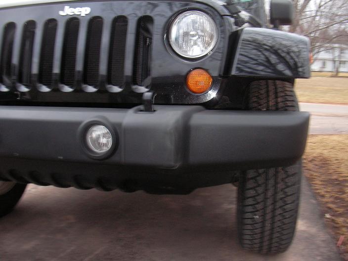

I had a few replys in the modified section.. But if this happens to anyone else just take a few hairdryers or a heatgun to it for a bit until the plastic warms up then just push the dents out with your hands.. it turned out not to bad just gotta find something to get rid of the scratches..
