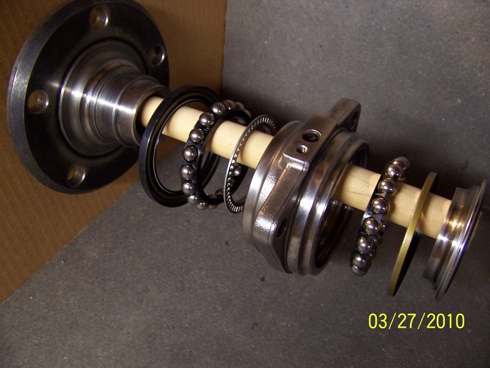

The sensor sticks into the hub next to the slotted tone ring. The ring may not be visible through the sensor hole.
Having the piece of the old sensor in there isn't good for the ball bearings. The piece could jam against the new one, I suppose.
