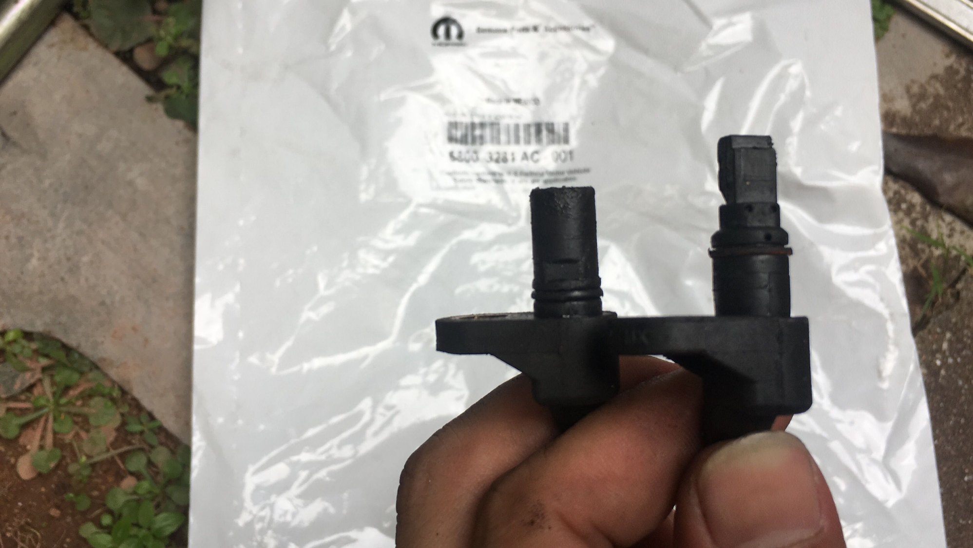

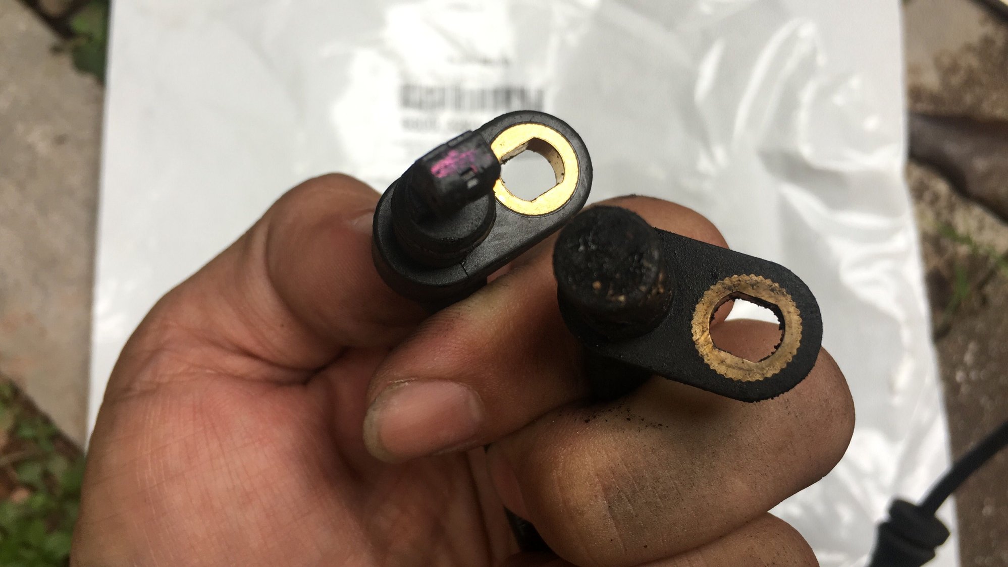

Hello all. I’ve got a 2008 JKU 4 doors. One of the wheel speed sensor in front is going bad and I’ve done a swap with the other front side to make sure the fault code goes to the changed side. I ordered a replacement sensor according to the part number and I received a different looking sensor than what was on the vehicle originally. I checked with various sources and they came back with the same new replacement sensor which I have problem fitting. It is longer by abit 10mm and the diameter which goes into the hole is over by 0.5mm. Anyone else has this similar experience? How did you resolve it? Thank you in advance for any help rendered.
Length of tip is longer by 10mm
The tip of the sensors are different
This is the part number.
The total length is slightly longer but not such a big concern.

When I changed my unit bearings about a year or so ago they came with the shorter sensors. Used them and works fine.

i couldn't ever find one. I ended up buying a new Timken unit bearing that came with a new speed sensor.
