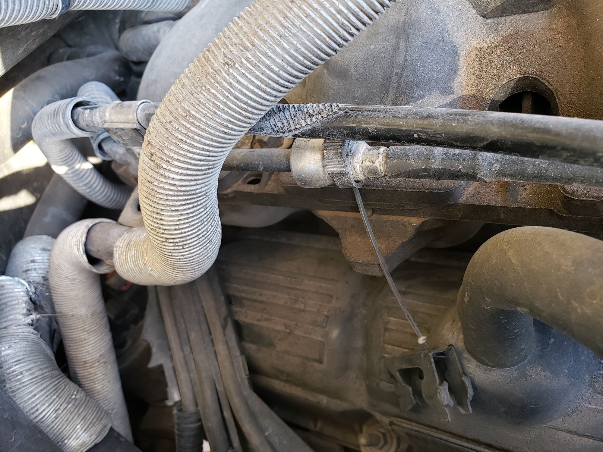

Old Apr 20, 2021 | 05:53 PM
WastedJake's Avatar
Joined: Apr 2021
Posts: 1
From: Tempe, AZ
Default Fix Question
Do you have any links to any videos by chance or even a picture? I think this is my exact problem. Want to fix this the same way you did.
Originally Posted by JEEP THRILLS
don't forget the system has more than just the canister, connection and gas cap.
the canister holds gas vapours and then burns them the next time the engine is run.
so there are lines that run up to the evap purge solenoid(under the hood)
I had a vent line that melted from being to close to the EGR tube causing a same affect leak.
I just patched it up with some rubber hose and clamps and the light wenrt out
