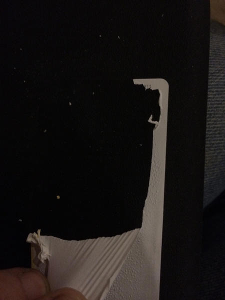

I had success with my 2014 Visor.
I was able to remove the sticker in about 25 minutes and it wasn't very painful. I read all the posts about removing the stickers and put some ideas together.
I used 100 grit sandpaper and sanded the sticker until it was almost through (you can see when you are getting close). Then I used goo gone. As you are rubbing it on you can see the sticker start to bubble. If you pull slow you can get it to peel off. Hardest part is sanding the sides of the sticker enough without getting the visor itself. You can see that I didn't get the edge well on my first try.

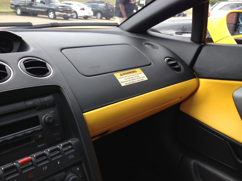

Any ideas on how to get this one off? I don't know why those Italians would put the damn thing right in the middle of my dash on top of leather! Idiots.

Appears to be a nice Gallardo.

Or a beetle
