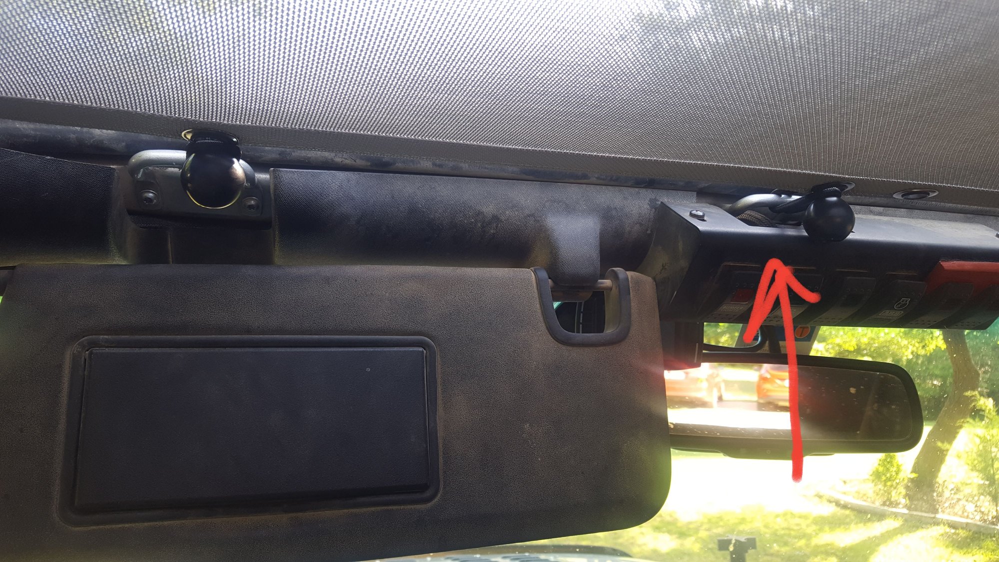

Yes, this guy -

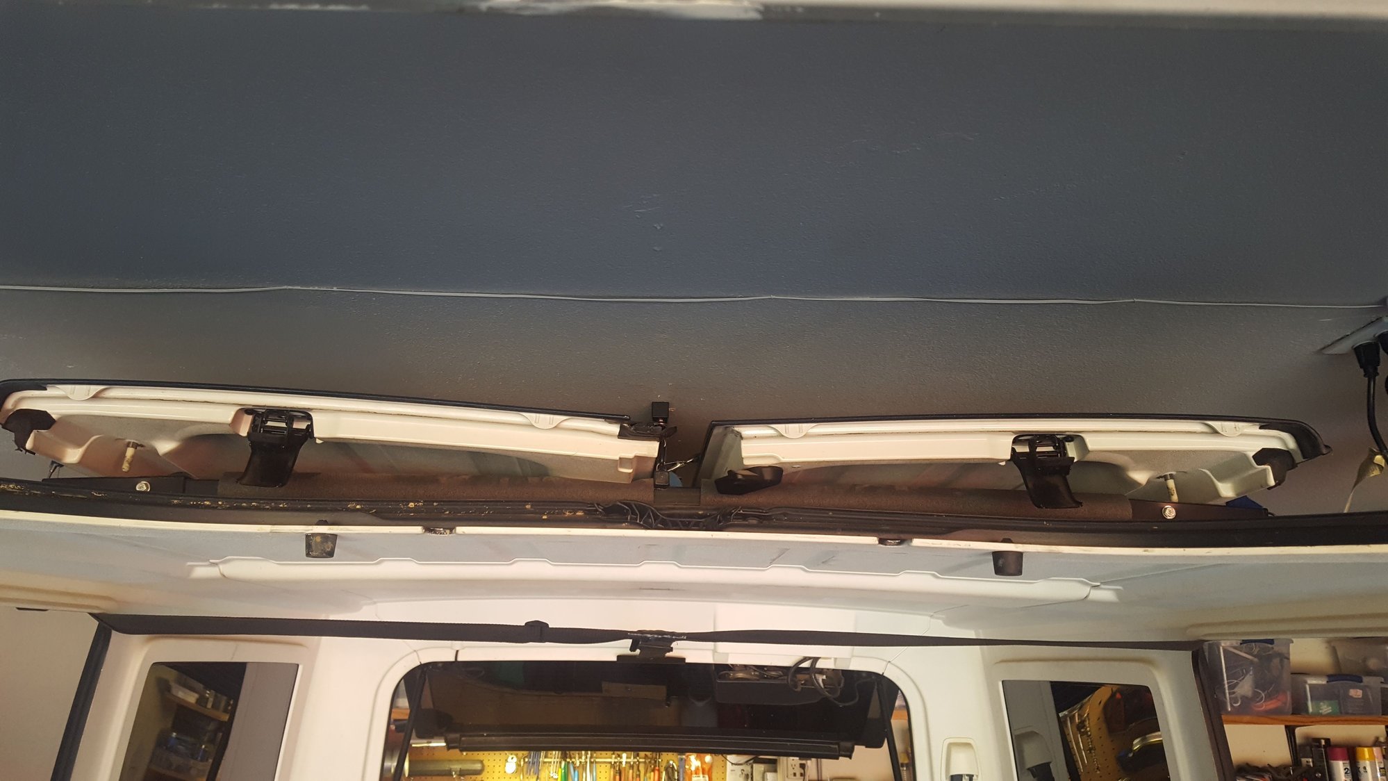

You have a clamp on either side of the freedom panels, and the a sliding clamp in the middle -
The position of that middle footman loop changes from the early years.

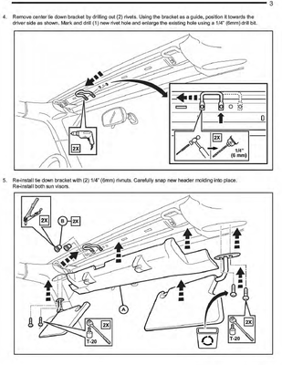

There is a kit from Mopar to accomplish this that includes a new plastic trim, or you can remove the right fastener on the loop, swing the loop over to the left, and drill and install a new fastener.
Here's the kit from Mopar.
Here's the info on how to move the loop if you don't get the kit.
We drill out the right rivet and swing the loop over to the left on the original rivet, then install a new rivet in the hole you drilled.
