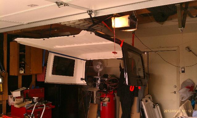

It's pretty easy, just take off the freedom panels and climb up and stand on the front seats to remove the 2 bolts, one on each side. Then remove the 6 bolts in the back and u can remove it. Should be OK with 2 people, first time I removed mine I had 3 people just in case but it isn't that heavy. And last weekend I removed it by myself using 2 ratchet straps and 4 bicycle hooks hanging from my rafters in the garage.
