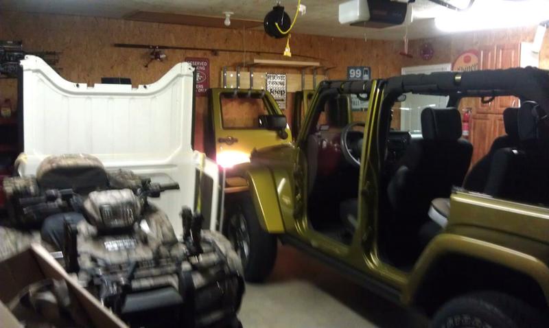

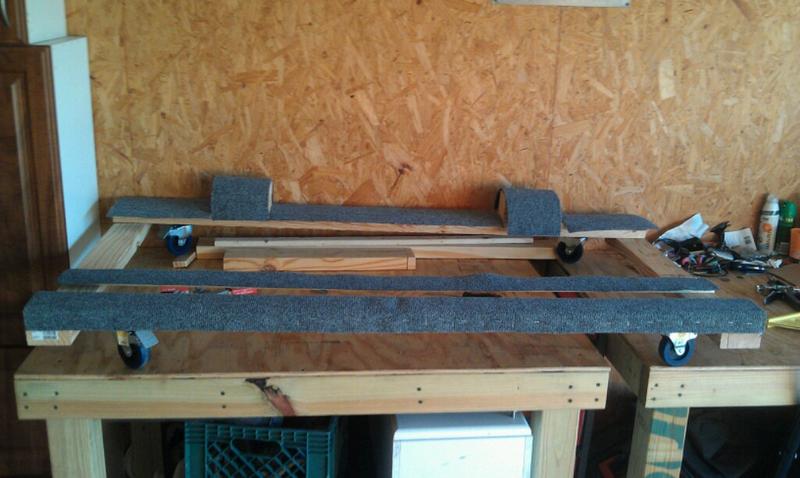

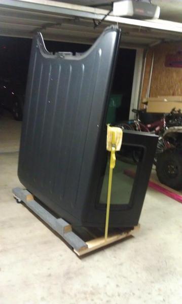

The cart is rediculously easy and cheap. Only takes up 30"x 60". So easy a wife could do it.

Old Apr 26, 2012 | 07:10 PM
scooby snacks's Avatar
Posts: 4,343
From: Wake Forest, NC
Attachment 309651
Attachment 309652
Attachment 309653
x2. You can even have Lowes or Home Depot cut the wood to size. If you have a drill can you drill pilot holes and then set your caster wheels and use your drill as a screwdriver to sink the screws. I bult mine in a half hour.

Exact plans my buddy and I used last weekend. The beer run took longer than construction.
https://www.jk-forum.com/forums/jk-w...op-cart-85305/
Old Apr 26, 2012 | 07:35 PM
TYDFAN's Avatar
Posts: 271
From: Nederland, Texas
Two 6" blocks per side in the back balance it better than 3.

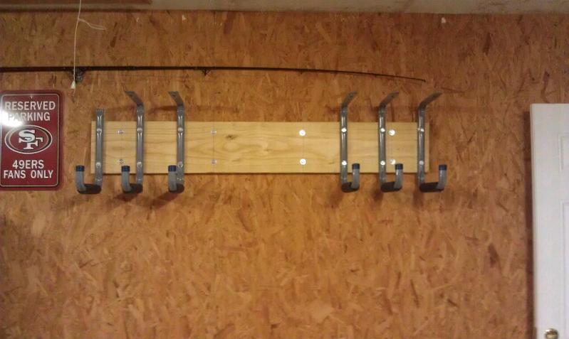

Question regarding the door hanging set up in the picture. Are those ladder hangers? Are they wrapped in foam or something? Are there two doors per hook or is there another set of hooks somewhere that isn't pictured?
Old Apr 27, 2012 | 08:10 AM
shag7265's Avatar
Posts: 657
From: Lumberton, TX
The hooks come with foam on them, Lowes sells them in the garage hanger section (ladder hangers , shovel hangers etc) yes 2 doors on each side but 3 hooks on each side to be safe.

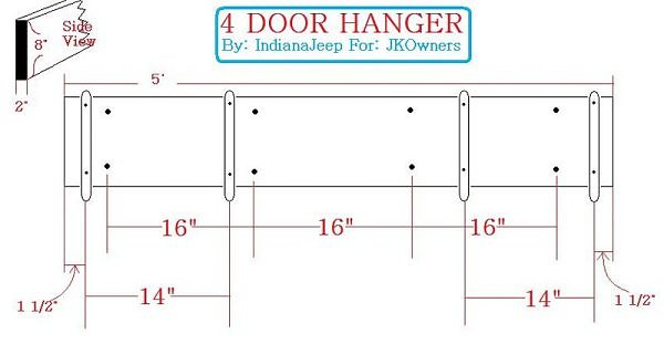

https://www.jk-forum.com/forums/jk-w...-doors-131132/
I used those instructions with that diagram.
