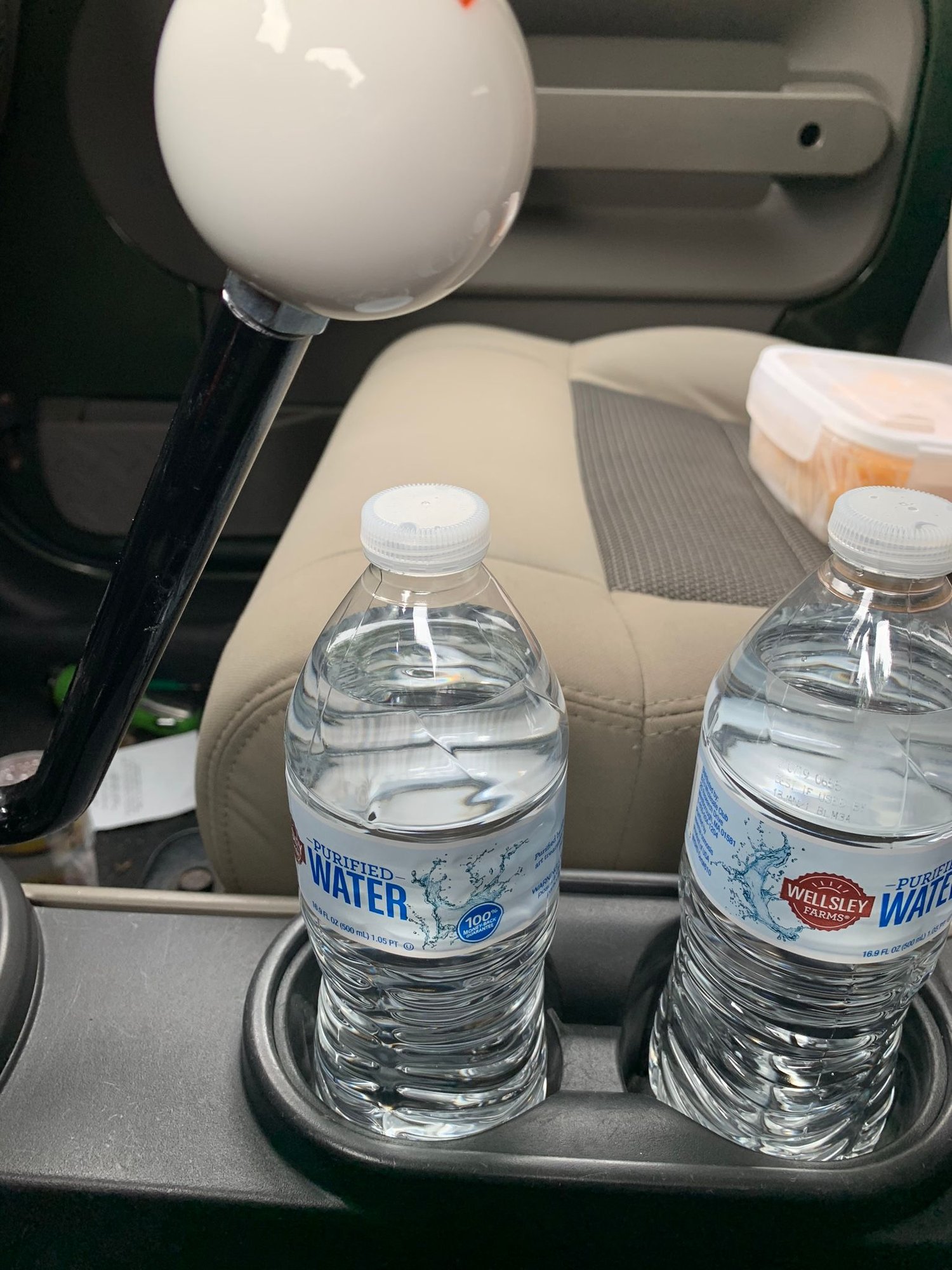

I made a new shaft with a threaded end and it is approximately 2 1/2 inches longer. I also took the 4wd shifter out and bent it and made a 2 inch extension for it. Cannot believe how much of an improvement it made! I made sure that I cleared the 4wd shifter and also was able to give some room so we can use both cup holders. Sounds a little trivial but originality the shifter would knock the water bottle or coffee mug out of holder before I modded it.
Very nice. That looks much better. It definitely makes a difference in comfort and driveability when you're constantly shifting gears. Did you just get a piece of steel rod and bend/thread it or is there somewhere I can but one like yours?
I see B&M makes extended levers just like yours. They are expensive. About $400 USD for the pair. I'm in Canada so after conversion, shipping, and duty, I'm probably looking at $600 - $700 CAD. Does anyone know of a company who makes cheaper extended shift levers for the jk. I'm not having much luck finding any less expensive options.

Hello, yes I made a new rod out of 5/8 steel and kept heating and bending it until I liked how it felt and had the clearance that I needed. I got the idea from seeing the B&M shifter handles. I cannot believe what a difference it makes in comfort! I found this link and may work for a lot cheaper.
