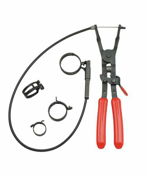

I've not personally changed these hoses but a tool like this should help since you can't get your hand in there.
