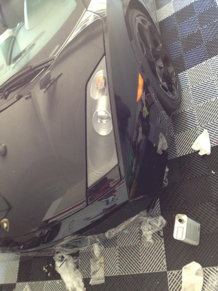

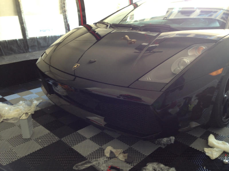

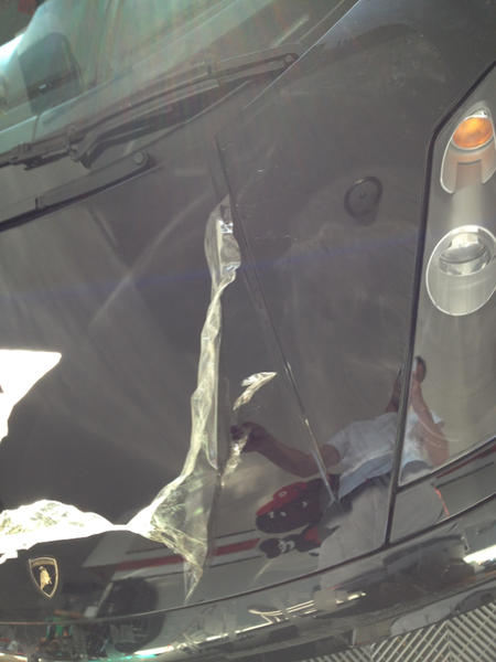

3m adhesive remover and it will fall off. Ive used it for removing a clear bra from my old Gallardo; paint safe and demolishes decals...
Using the proper tool for the job is always the first step. I wouldn't use alcohol or acetone on a vehicle. If you can buy it at Walgreens it doesn't belong near any vehicle you care about....
Get the 3m adhesive remover from your local hardware or automotive paint supplier...

Originally Posted by Rploaded
3m adhesive remover and it will fall off. Ive used it for removing a clear bra from my old Gallardo Paint safe and demolishes decals...
Attachment 489016
Attachment 489018
Any retail stores I can pick it up at?
