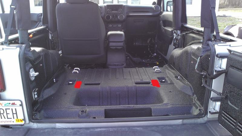

So I took my rear bench seat out last week to re-install my carpet after enjoying my first summer of Line-X. Now with everything back together, the seat won't latch down to the rear mounts.
Only thing I can think of is the carpet height is keeping it from latching, but I can distinctively hear the metal clasp hitting the metal rod in the floor when I push down on the seat. Makes me think I might have to make a trip to the Stealership and have them look at it. Any brilliant ideas before I resort to their "expertise"

That's not the issue at hand. I tried both methods of having the back locked back and also with it folded forward. Neither locks.
I did take a tissue and lie it under the seat then held the seat down and tried to pull the tissue out without ripping it (to find tight spots). I did find that the tissue tore when placed on the inner sides of the latch between 2 and 4 inches away from the locking mechanism. See the picture if that makes no sense....the red areas are where it is tearing. I'm kinda thinking Ill just have to trim the carpet now.

lol, I'm thoroughly amused how there is ZERO assumptions made regarding the wisdom/common sense. I'm sure it's all in good nature, but I know how the seat installs. I'm fairly mechanically minded and it's really so easy a caveman could do it. For the time being I folded that center piece of carpet back (out from underneath the seat) and the seat latches perfectly. Pretty sure my new goal is to find out how to cut the carpet so it still looks ok and is functional with the seat.

Do you think the layer of bedliner is too thick and it's keeping the seat frame from sitting/laying down on top of the carpet low enough to latch?
