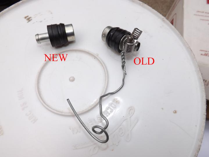

Well, I finally got it out. Thanks for the suggestions. I ended up using a small hose clamp and wire around the clamp to lift it out (I couldn't put it back together to get the engine hot):

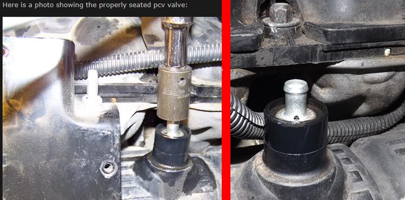

How do you know if it is seated? I couldn't push it down at all, so I tapped it down with a deep socket to where I think it was seated, never heard a snap or pop. Anyway, I put it back together and it started up, no CEL. Will go for a cruise in a little bit.

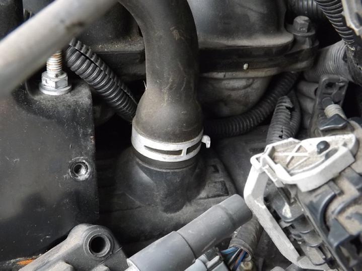

I knew I was in for trouble when I found the hose clamp facing off to the side, who does that? Had to use an angled needle nose pliers and a metal loop to turn it around.
Here is a photo showing the properly seated pcv valve:
Thanks for taking the time to post your pic. Opened mine up again this morning to check. I think it looks similar to yours. Does it matter in which direction that little hole sits? (Crossing my fingers it doesn't):

It doesn't matter which way the hole faces.
