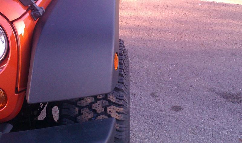

My wheels are 16x8.5" and have 4.5" of backspacing. My 285/75s stuck out from the fenders about 1 inch or a tad more at each corner. Really, it was just about perfect. The tires never rubbed while steering, unless I was in reverse and turned full lock.
