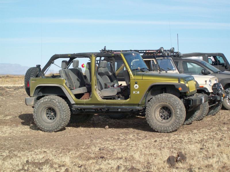

So I go to Martin tire Co. Today and ask around for rims...I drive a 2007 jk with 17 OEM rims...and the guy tells me I cannot go with a size 15 rim cause it will rub with the calipers?...cause my vehicle came with 17's....I can only go with size 16 and above....has anyone experienced this?...
Hey buddy. Just saw this. I don't know if you remember, but on my old 08, I was running a Pro Comp 52 in the 15x10 flavor. First with a 36x13.5-15 Irock and then a 37x14.5-15 Toyo. Those wheels fit with absolutely no rubbing or grinding needed.
Here she be sporting the Toyos.
Damn I miss this Jeep!
Let me know if you have any questions.
