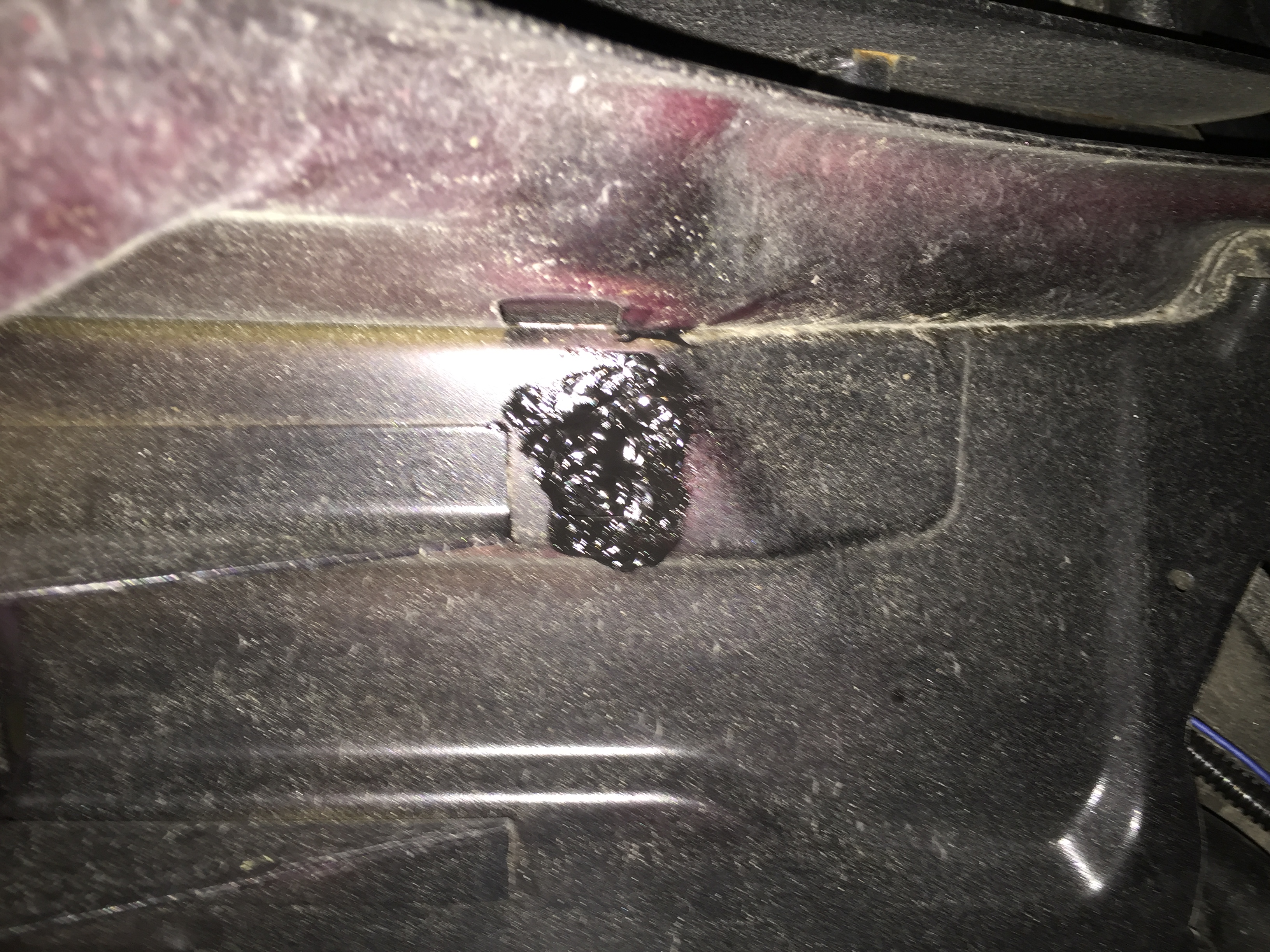

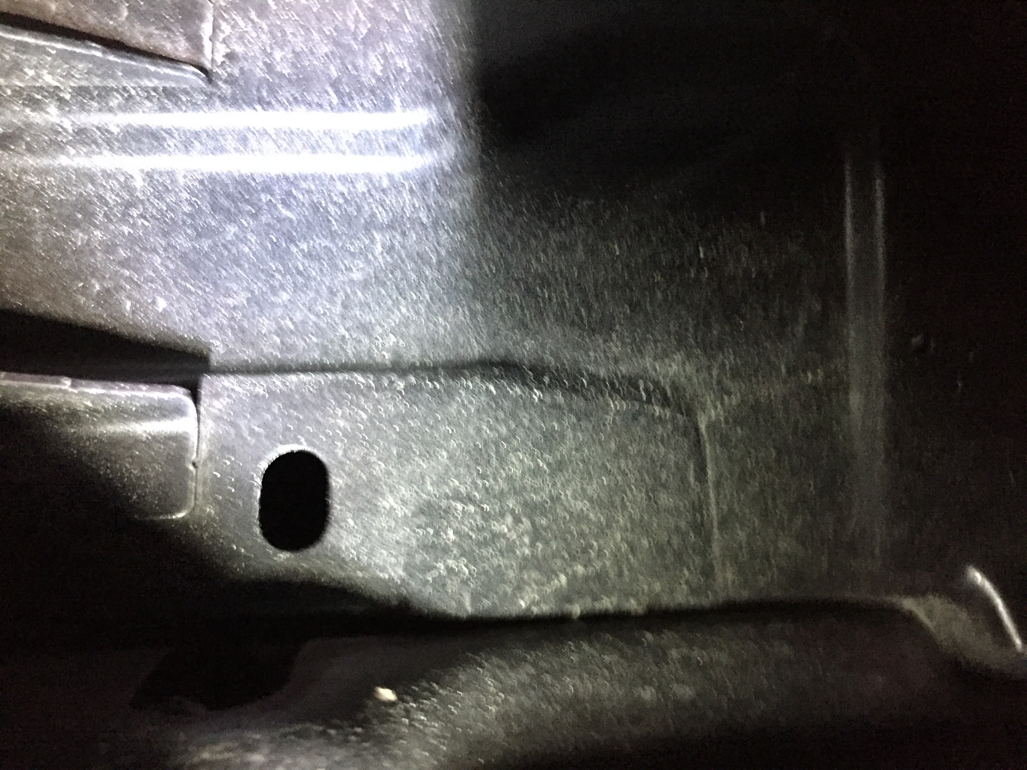

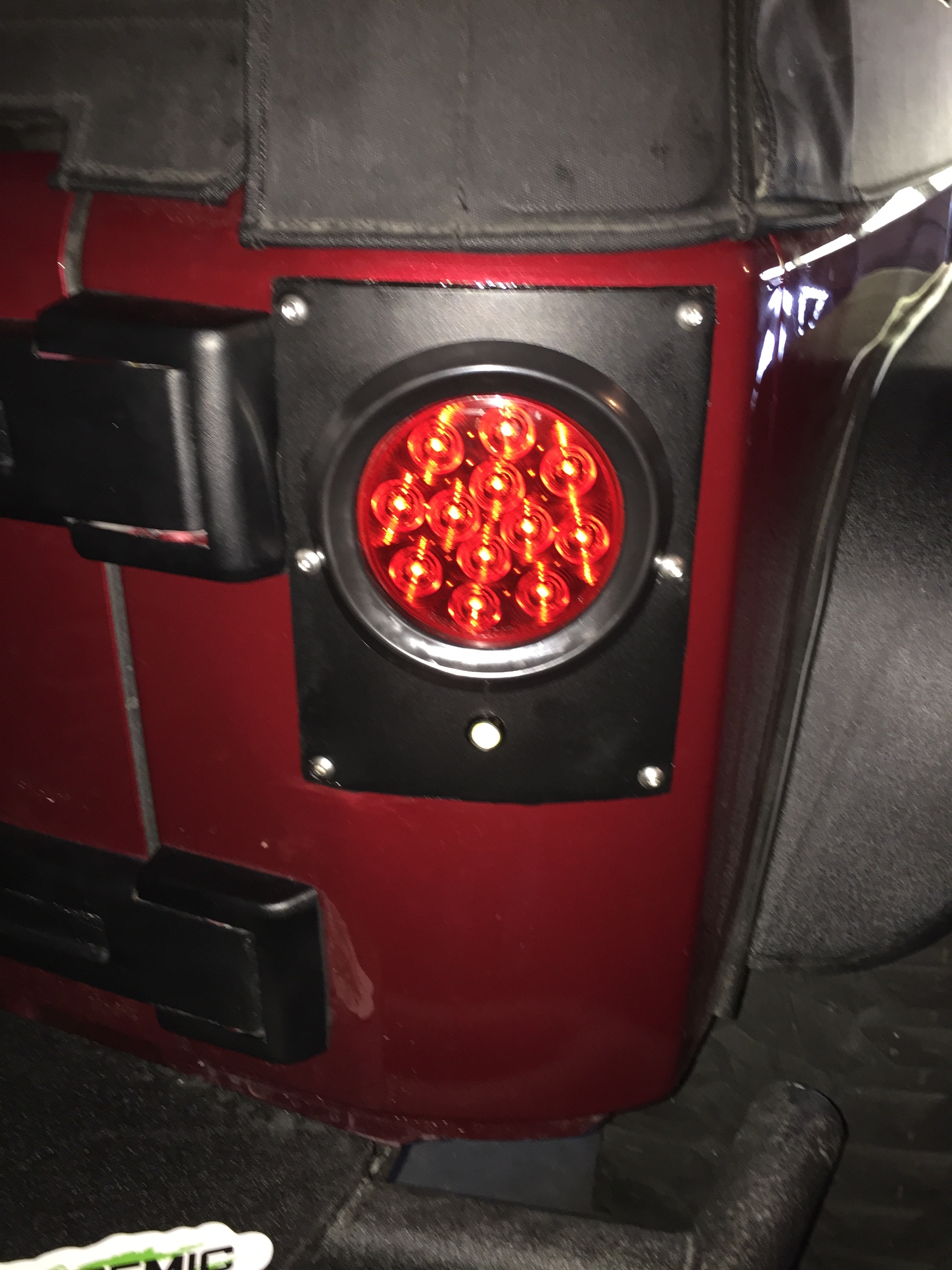

Brankz, If you Run without fender liners in the rear. (I have them in the front) There is a hole in the metal from the factory that needs to be sealed with some RTV. I used Diff cover gasket RTV on it. If you don't seal it up your going to get all kinds of crap in there when you go Wheeling.
Here are some pics, I also Have Pandemic Flush mount Taillights
