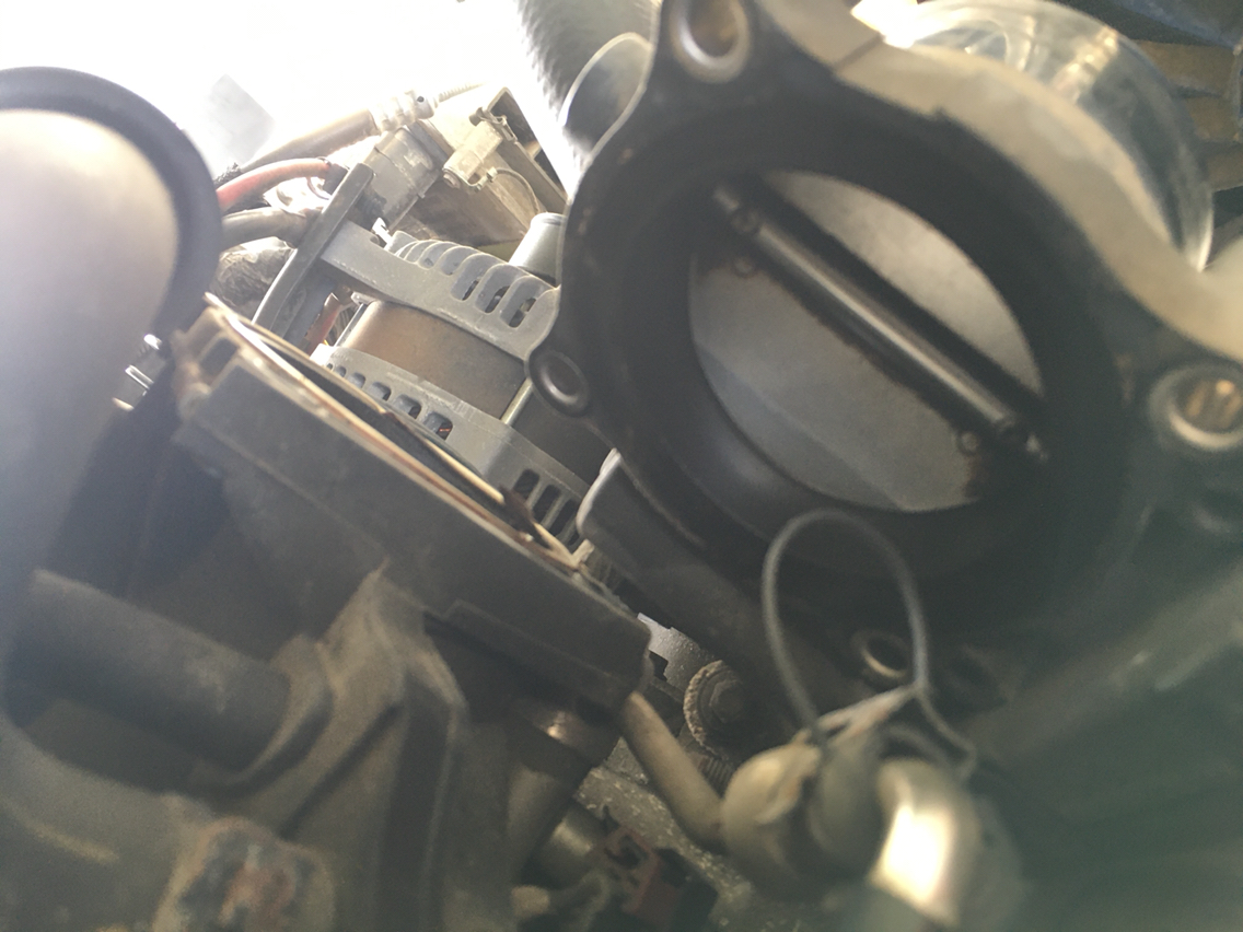

Here is a picture of it.

It looks right, especially since the part number crosses. The 3.7 in the Liberty can use the same O-ring (gasket) as the 3.8L in the JK, but there is always a bit of doubt since they apparently made more than one style 3.8L intake manifold -- which is very strange. I'd just pull it apart and compare.

Here we go
ID:	677593   Click image for larger version
ID:	677594   Click image for larger version
