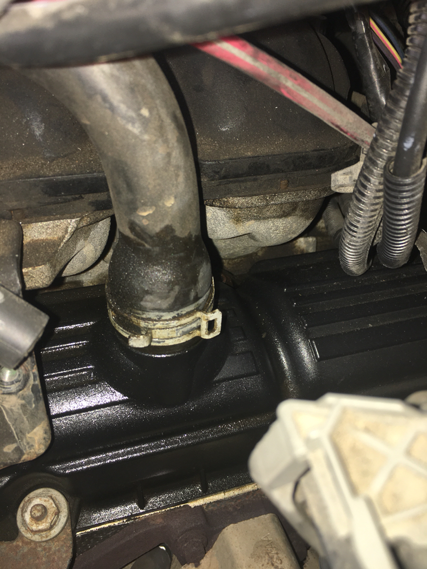

PCV valve was not fully seated and oil on valve cover. I know I put it all the way down last time. This time it was just kinda sitting there. The first time I changed it also it was just sitting there. Never have I ever (lol) had to pry it up. All 3 times I just pick it up and out.

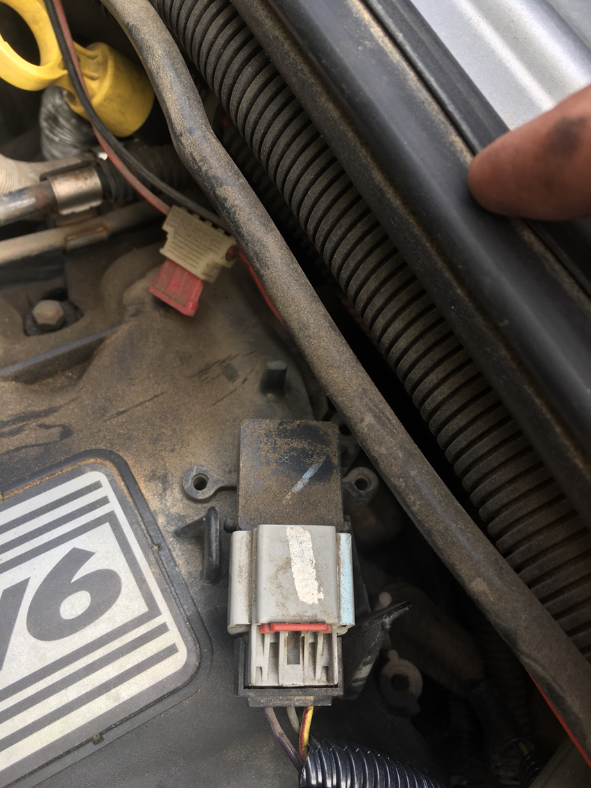

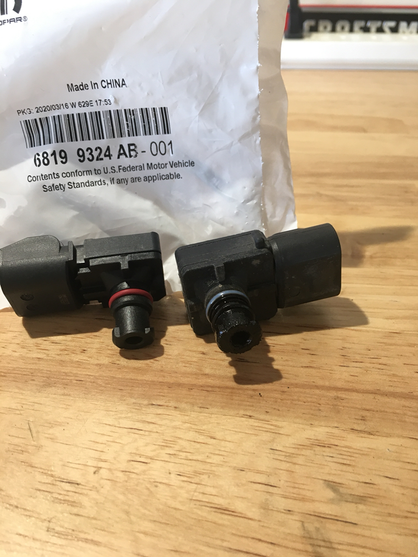

I seated it fully and went for a drive and same thing. I'll assume the picture is of the MAP sensor which I'm trying next. Is there a piece missing that holds the MAP sensor in place or screws?

MAP sensor looks a little gunked up.

Looks like you've got it worked out, good luck with the MAP sensor.
Interesting that you have had the PCV come out by itself too. Also strange that is doesn't mess the idle up very much, but it does suck oil. I'm pretty sure it gets sucked up into the tapered hose and makes a decent seal, then drops down as vacuum decreases.
Does the PCV valve look fully seated in the picture or does it go down further?
Old Jun 22, 2020 | 06:10 PM
  #40
Mr.T's Avatar
Community Favorite
Posts: 2,199
Likes: 218
From: Over the hill
Yep, looks right. The trick is that it goes from tight to easy to wiggle when the rubber goes into the groove.
