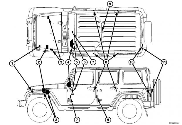

I just received my 2008 JK Rubicon Unlimited. I'm very interested in getting the Jeep Security System to work at its full potential without mixing in aftermarket alarm or CANBUS bypass modules. After researching multiple Jeep/MOPAR part web sites, the JK parts manual, and the JK service manual these are my findings:
From Service Manual:
The Vehicle Theft Security System (VTSS) is an available factory-installed feature on this vehicle. The VTSS is comprised of two primary subsystems: the optional Vehicle Theft Alarm (VTA) and the standard Sentry Key Immobilizer System (SKIS). The VTA is an active system that provides visual and audible responses as deterrents to and warnings of unauthorized vehicle tampering. The SKIS is a passive system that effectively immobilizes the vehicle against unauthorized operation. Following are paragraphs which describe these subsystems of the VTSS.
ElectroMechanical Instrument Cluster - The ElectroMechanical Instrument Cluster (EMIC) (also known as the Cab Compartment Node/CCN) provides security indicator control. (Refer to 8 - ELECTRICAL/INSTRUMENT CLUSTER - DESCRIPTION).
Powertrain Control Module - The Powertrain Control Module (PCM) provides the SKIS engine control logic.
Totally Integrated Power Module (2) - The Totally Integrated Power Module (TIPM) is located in the engine compartment, near the battery. The TIPM monitors door, swing gate and hood ajar switch status and provides the VTA system logic. Except for the Sentry Key transponders, which rely upon Radio Frequency (RF) communication, hard wired circuitry connects the VTA and SKIS components to the electrical system of the vehicle. These hard wired circuits are integral to several wire harnesses, which are routed throughout the vehicle and retained by many different methods. These circuits may be connected to each other, to the vehicle electrical system and to the SKIS components through the use of a combination of soldered splices, splice block connectors, and many different types of wire harness terminal connectors and insulators. Refer to the appropriate wiring information. The wiring information includes wiring diagrams, proper wire and connector repair procedures, further details on wire harness routing and retention, as well as pin-out and location views for the various wire harness connectors, splices and grounds.
VEHICLE THEFT ALARM (VTA) -The VTA is available in two different configurations for this vehicle: One configuration is designed for vehicles manufactured for sale in North America; while, the other configuration is designed for vehicles manufactured for sale in markets outside of North America, also referred to as export markets within the context of this service information. In addition, the VTA for export is available in two versions: base and premium. All vehicles equipped with VTA are also equipped with the Remote Keyless Entry (RKE) system and the Sentry Key Immobilizer System (SKIS), regardless of their market destination.
The North American and export base version of the VTA system provide perimeter vehicle protection by monitoring the vehicle doors, the ignition switch, the swing gate and, for vehicles built for certain markets where it is required equipment, the hood. If unauthorized vehicle use or tampering is detected, these systems respond by pulsing the vehicle horn as an audible deterrent and flashing certain exterior lamps as a visual deterrent.
The export premium version of the VTA system is only available in vehicles manufactured for sale in certain markets where it is required equipment. The export premium version of the VTA provides the same perimeter protection features as the base version, but adds interior [microwave] vehicle intrusion protection. The export premium VTA also enhances the pulsing horn feature of the base version with an alarm siren as the audible deterrent, while retaining the flashing exterior lamps as the visual deterrent.
The VTA includes the following major components, which are described in further detail elsewhere in this service information:
Door Ajar Switches (8) - A door ajar switch is integral to the door latch mechanism of each front and rear door. (Refer to 8 - ELECTRICAL/LAMPS/LIGHTING - INTERIOR/AJAR SWITCH - DESCRIPTION - DOOR AJAR SWITCH).
Hood Ajar Switch (1) - A hood ajar switch is located in a bracket on the inboard side of the left front fender load path beam within the engine compartment of vehicles built for sale in certain export markets where it is required equipment.
Intrusion Module (5) - An intrusion module is located on a bracket on the lower instrument panel reinforcement beneath the driver side instrument panel in the passenger compartment of vehicles built for sale in certain export markets where it is required equipment.
Intrusion Sensors (7, 9 and 10) - Two (two-door vehicles) or three (four-door vehicles) microwave intrusion sensors are located within the passenger compartment of vehicles built for sale in certain export markets where it is required equipment. One sensor is located within the lower center stack area of the instrument panel, another is located within the rear of the center floor console (four-door vehicles only) and the third is located within the swing gate.
Swing Gate Ajar Switch (11) - A swing gate ajar switch is integral to the latch for the swing gate in the vehicle. (Refer to 8 - ELECTRICAL/LAMPS/LIGHTING - INTERIOR/AJAR SWITCH - DESCRIPTION - SWING GATE AJAR SWITCH).
Security Indicator (4) - A security indicator is integral to the ElectroMechanical Instrument Cluster (EMIC) (also known as the Cab Compartment Node/CCN). (Refer to 8 - ELECTRICAL/INSTRUMENT CLUSTER/SECURITY INDICATOR - DESCRIPTION).
Siren (3) - An alarm siren is located on the right component tray (gasoline engine) or on the inboard side of the left front fender load path beam (diesel engine) within the engine compartment of vehicles built for sale in certain export markets where it is required equipment.

5. Intrusion Module (5), 05026290AD (AKA: Alarm Module - The Brains)
6. Intrusion Sensors (7, 9 and 10)
6a. (7) and (9) are identical sensors, 05026117AC (Front and Passenger)
6b. (10), 05026318AA (Located in Tailgate for Cargo Area)

What does all of this mean?
This is the EVS I feature quote: "The EVS I Security System for Jeeps with keyless entry. Enjoy the convenience and peace-of-mind of electronic exterior and interior protection with Mopar EVS I Security System. Specifically designed to add security features to your existing remote keyless entry transmitter."
The EVS I has a part number of 82209992AC for the Wrangler. I cannot find this number in either the Part or Service Manuals.
As a result, I think we can draw one of two conclusions:
A) EVS I is a package containing the "export premium version" parts
1. Siren + Mounting Bolts
2. Hood Switch + Mounting Bracket
3. Front Passenger Area Microwave Sensor
4. Rear Passenger Area Microwave Sensor
5. Cargo Area Microwave Sensor
6. maybe >> New Alarm Module - I say maybe because the stock module should not need to be exchanged/upgraded since all parts seem to communicate using the vehicle CANBUS. Also, it would not be cost effective for Chysler to manufacture multiple alarm modules with the differences being only a few motherboard components.
B) If your JK was built for North America and has a remote lock/unlock key FOB then you already have EVS I. To get the features of the "export premium version" then you will have to order all parts separately and install them.
How do we know which conclusion to consider?
1. Someone provide a complete inventory of EVS I kit with part numbers.
2. Someone look at their Alarm Module to see if it matches part number for (5). If it does, then conclusion B is more evident.
Lastly, if conclusion B is the way to go, then we would need cost estimates. Looking at the connectors, all parts seem to be plug-n-play, so you could do it at home without dealer labor costs. Too early to tell if a CANBUS flash would be needed to activate the new sensors.
Just trying to clear or muddy the waters a bit.
