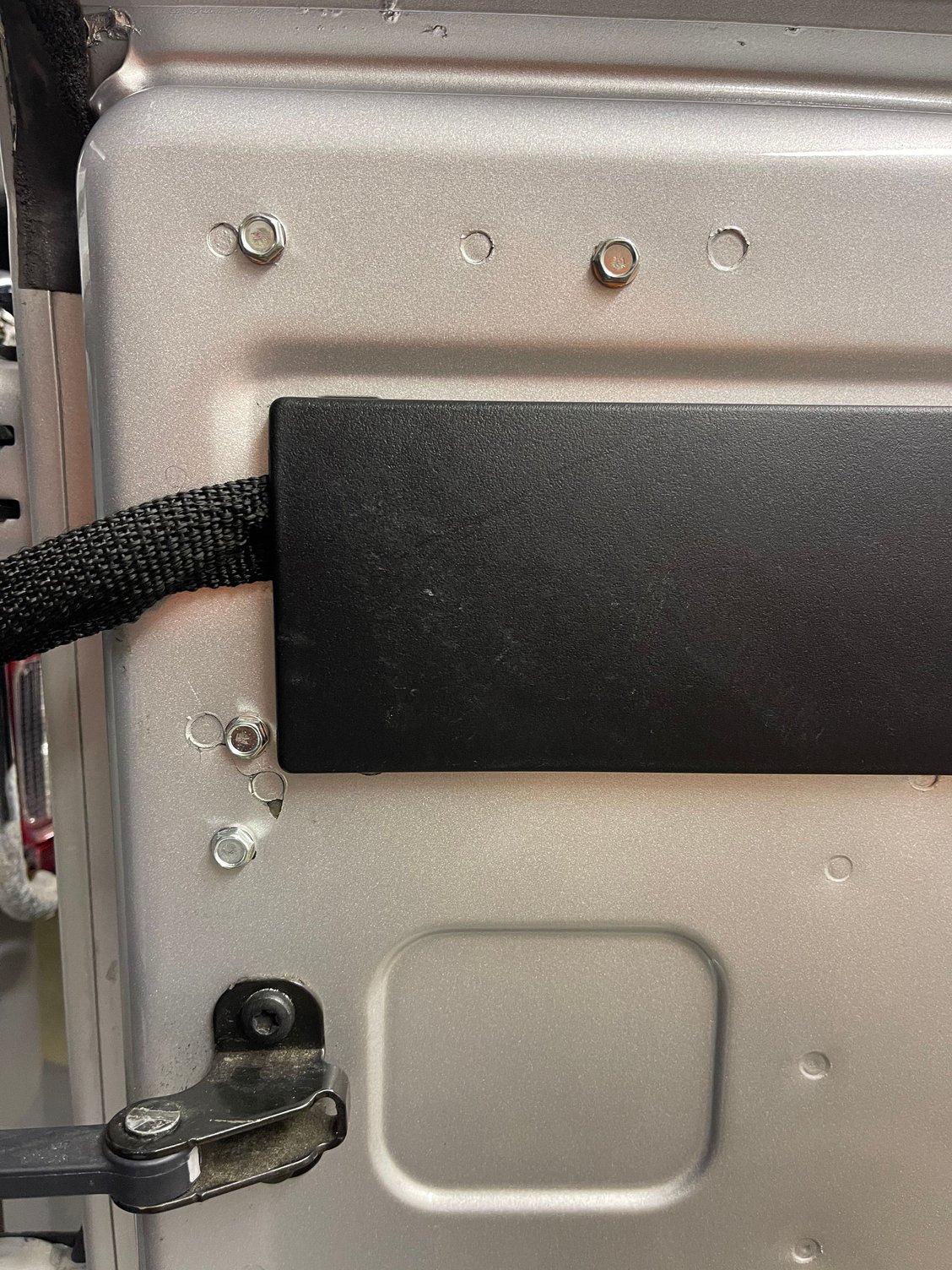

Good evening to all, I was thinking about grinding having my buddy spot weld and then painting the tailgate but I came up with a nice decent solution which I can’t believe it actually worked. I followed the well spots where the cracks were pre-drilled and installed self tapping screws, and it worked excellent and there is no noise. Maybe if somebody else is having the same problem, they can try this solution it worked for me.

Good morning, ever since I did those self tapping screws I haven’t had any noise and also has held up very well, I tap on the tailgate panel once in a while to see if I hear any loose welds but it’s holding up fine, hope this helps

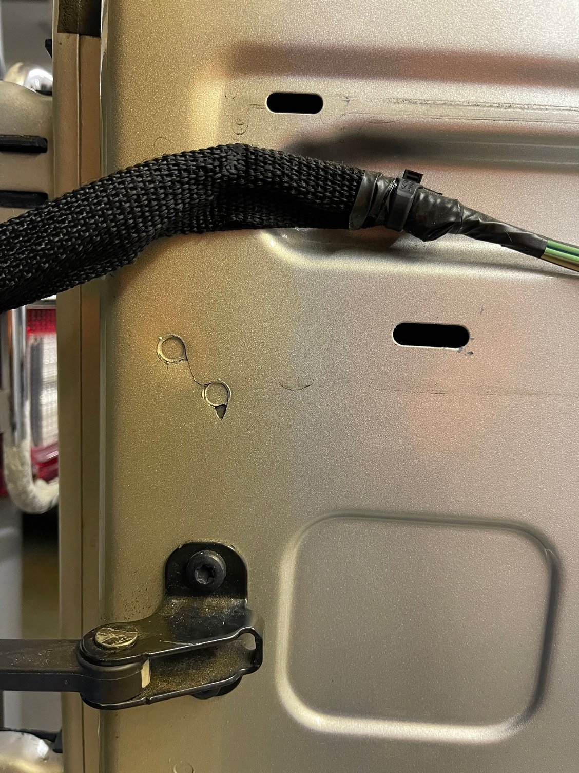

This is my crack. It starts above the door check hinge and goes around that all the way down to the louvers, one of which is cracked. Do you think I will be able to put screws on both sides of the crack? I tapped around the crack and I don't feel any steel support on the right side of the crack. Sounds solid on the left side of the crack. Any thoughts? Perhaps dremel along the crack and jb weld?
