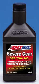

i have had good results with the following:
ID:	143947Click image for larger version
ID:	143948Click image for larger version
