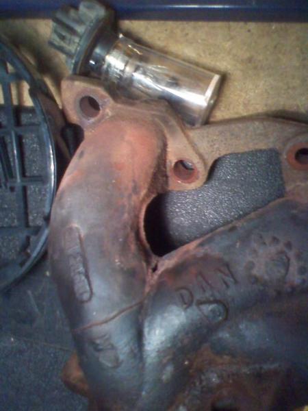

The manifolds are cast iron and not particularly well made it seems. The good news is that even if you're out of warranty, it's fairly easy to replace the manifolds and they are fairly cheap so it won't cost you a fortune anyway. The cracks are usually quite visible and an inch or so long, so it's just a matter of removing the heat shields (undoing a few bolts) and having a look at the manifold underneath.

Here's a pic of one; you can see the crack on the 1st pipe near the join:

Great stuff...Thanks so much. I actually added the 30weight oil today and the noises are all to a min so may have just been a lifter etc. I may need to check the manifold out though just to ease the mind. I was under the rig today and saw everything you are mentioning. Including the heat shields. Much obliged.
Apart from the risk of getting exhaust fumes into the cabin via the ventilation system (if you're at standstill and idling for a long time with the blower fan on then this is a possibility) it's not particularly dangerous as such; there's a heat shield fitted over the manifold anyway, thus reducing the chance that escaping hot exhaust gasses could melt a spark plug lead or start a fire or something.
Attachment 102634
