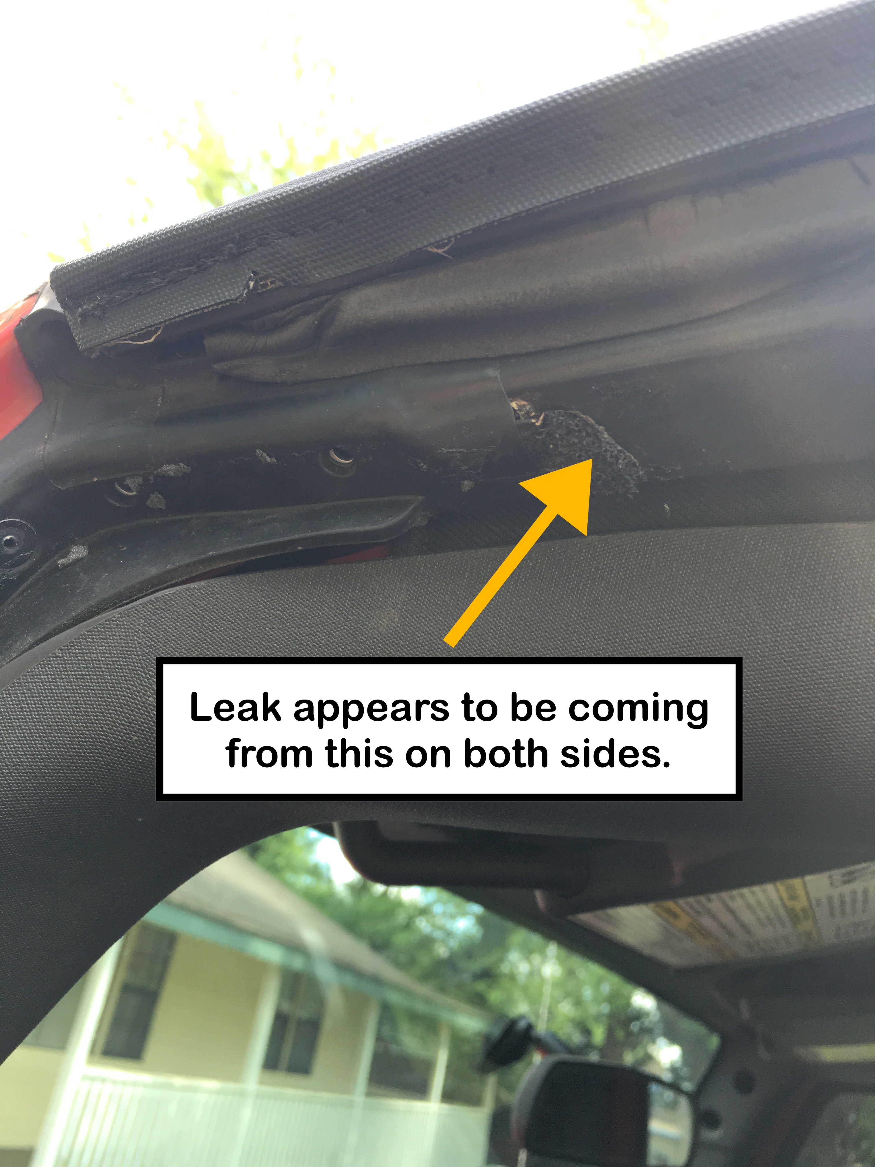

Good morning all.
I've got an 09 JK that's got a leak coming from the top where the doors meet up with the header seal. It appears to be coming from the spongy piece. Does anybody know from previous experience whether or not this could be either the windshield header seal, mucket, or just a bad top? Click image for larger version

Leaked in mine since 6/2007.
Tons of info on this though. Thread after thread of attempts, solutions, constant dealer visits, and disappointment.
I tried silicone, padding, then just started setting something there to catch the water.
It did get better when I got a new Bowless top.

I had taken my jeep in about 10 times to get the top to stop leaking. It was a long process of bringing it to the dealer, them "fixing it", waiting for it to rain, then bringing it back. That was one of the spots that it leaked from. They make a kit with foam strips and im pretty sure that's what fixed it that time. Mine ended up being warped freedom panels. Looks like you have a soft top though. Good luck!
Pretty sure this is the diagnosis manual they used a couple times:
http://www.meyerdistributing.com/mar..._for_Leaks.pdf

Took me 6 or 7 times at the dealer and two trips from the factory rep. It did finally get fixed. Just be patient and persistent with them. I can now say I'm leak free with the soft and hard top. I believe they ended up having to make adjustments to the door and that finally fixed it. For a while they were just throwing new seals at it every time.

I have an 08, the passenger side leaked so bad I had 2" of water in floor. Pulled plugs for a while. Found new door gaskets at Quadratec. Ordered one for each front door, about $120 total. So far, no leaks and floor is dry. May change tomorrow, but for now it is good. They are easy to install and I could tell a big difference between old and new gaskets.
