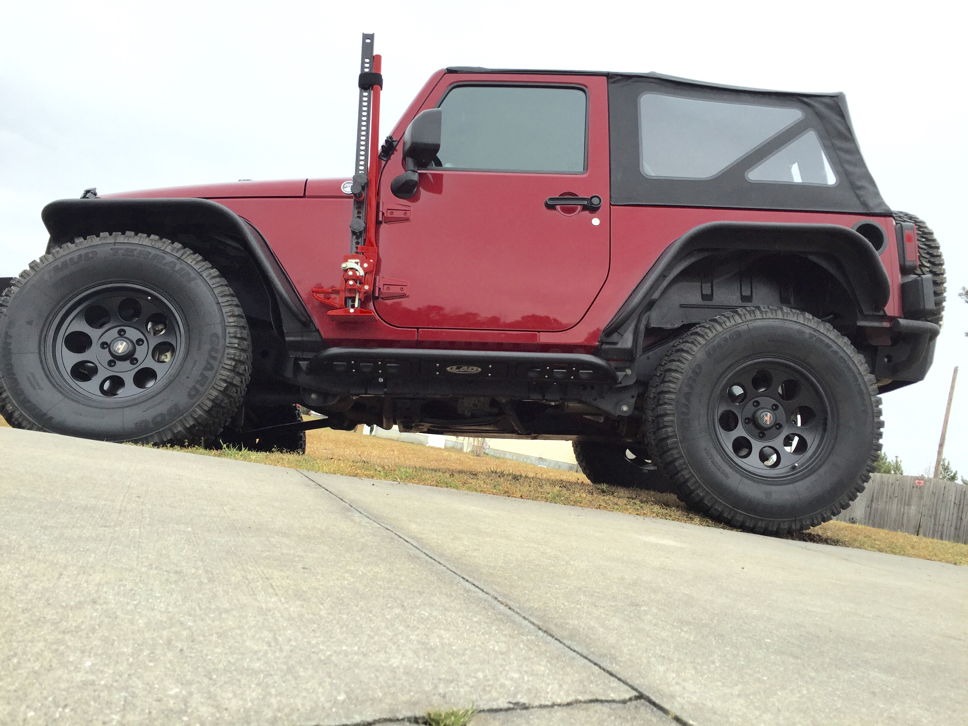

Originally Posted by jk_sea
Awesome, thanks guys. I need to pull the wheels off the Jeep and go get them balanced and the TPM question was nagging me, if I had been running with only 4 sensors on a 5 tire rotation. Good to know they've all got 'em
TPMS is waste of technology. I can check my own PSI, it will go off if you air down and you will see that annoying TPMS light on the dash. First week I had my new Jeep I took my stock steel wheels off put new wheels and tires on them and Just turned off TPMS using AEV ProCal and never looked back.
