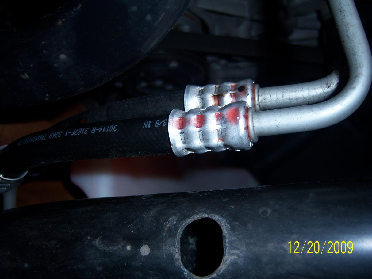

ID:	34303 My lines are leaking badly on the Trans cooler lines .. any one else have or had this problem ?

It's pretty common, especially on poorly crimped connections. I would take it in and get it fixed. Should be under warranty.

Have had them replaced .. lets hope they hold out for a few yrs ....

check to make sure that it is not leaking from where the lines are coming out of the tranny. The wifes were leaking from there, this was probably because the clip that holds the lines up was broken.

I was recently up to see my daughter (TigerLily) and noticed that the trans cooler line on her '09 2 door was leaking just like that in the photo above. She has ~32k miles on her jeep (in 1.5 years - she drives alot). She's taking it in next week and we'll see if they'll replace it under warranty.
