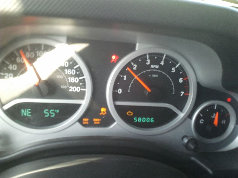

Does it do this at all? Mine had an issue where, while driving, most of the dash lights would come on and I would get the dreaded dinging. Sometimes the lights would go out and the check engine light would come on. As you can see in the picture it was a bit weird to have all these lights on while going 60 down the highway. My tach would also flip out and the speedo would go to zero and back up again.
Turned out the TIPM was bad. Funny thing is I also just had my wifes TIPM changed in her 2011 as well. Weird.
