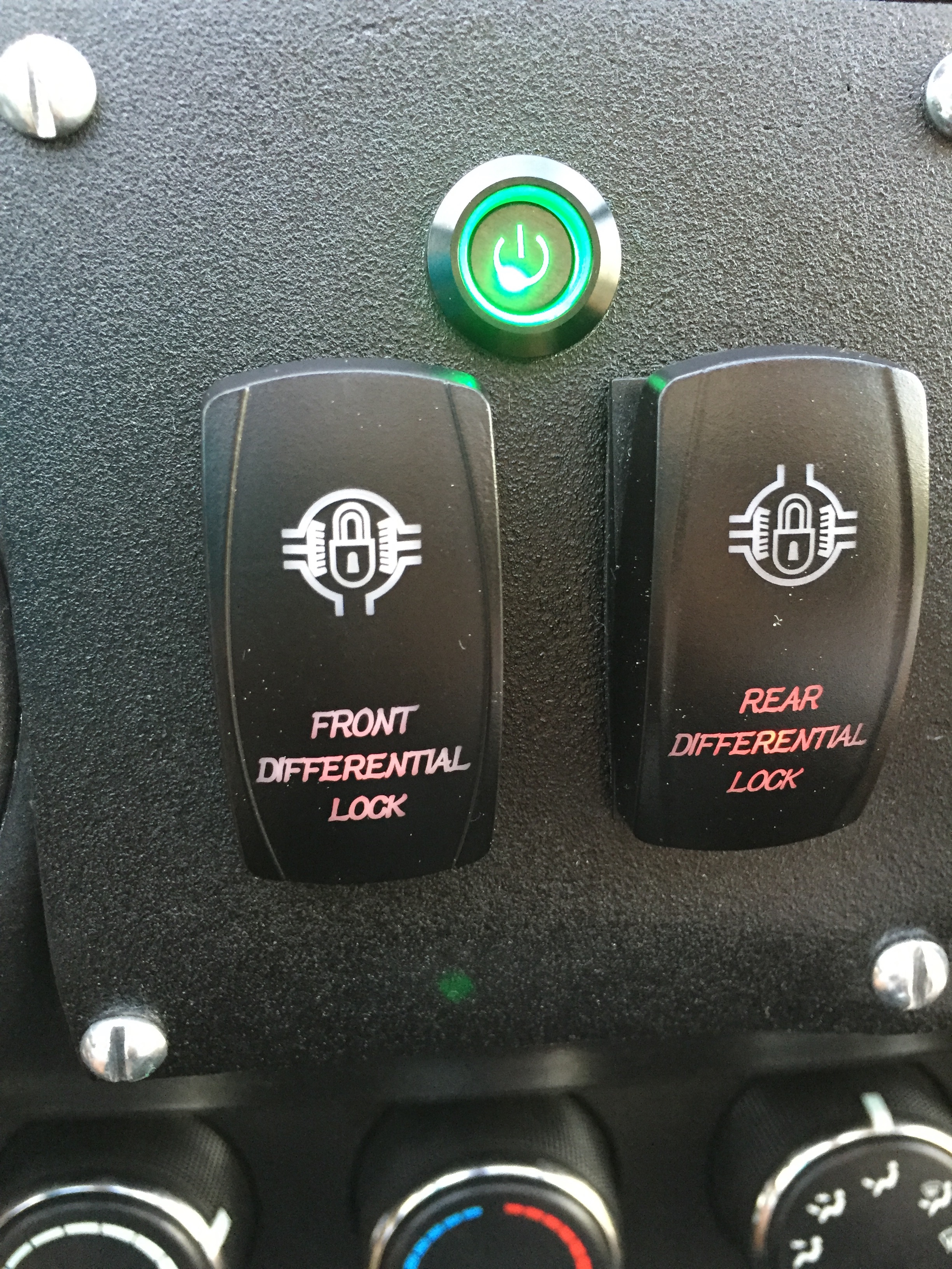

Put it in 4L lock the rear first. On grass or gravel... Pavement if you want. Do a donut you will feel the Jeep Buck and the Wheels Hop... Thats How I check my rear. The front same thing Lock it up Do donut with the front just locked your going to notice the steering is hard and the front wants to dip you will also feel it in the wheel.
This is how I check my non-Rubicon Jeep with Eaton E-lockers. Great part about mine is I can use my lockers in 4H or in 2WD for the rear.
