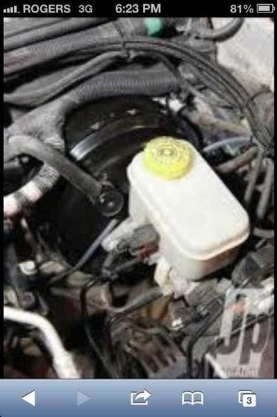

The Seafoam works great and after the first treatment through the brake booster line( which gets the throttle body as well as the entire intake) most of the carbon is cleaned. 6 months later i did a second treatment and there wasn't nearly as much of a smoke show

From: Great Lakes
Originally Posted by JustTryingToLive
i am interested in doing the seafoam treatment thru the lines, but not sure exactly which line. if someone could snap a shot of the correct line, i would be extremely grateful. thanks
Pour the Seafoam slowly into the line to the left of the master cylinder....Click image for larger version

im not following where this stuff goes sea foam in your gas tank????? ! I have 12,000 miles on mine
is the ccc stuff from Chrysler?? and do they recognize sea foam as a preventive step ? or does Chrysler frown on this ? never herd of either in my life why isint this in our maintenance book ?
maybe some right up how to put this into intake would help im not clear on this last photo posted ?

The rubber hose/line on the brake booster. (the black round thing) It is a vacuum line that will suck it into the engine properly. There are videos all over youtube. Just search for Seafoam. Watch a couple of them, and pay special attention to how slowly you have to let it "sip" the Seafoam.
