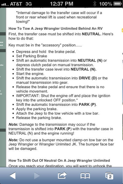

Rather than pulling fuses can't we put the transfer case into neutral to prevent mileage from going up? I thought the speedo and mileage were controlled by input and output sensors on the transmission/transfer case and not controlled by the wheel speed, but I could be wrong. I may have to flat tow the jeep soon so I will have to test it out somehow.
From quadratec:

Originally Posted by rob_engineer
From quadratec:
Thanks. That's what I was looking for
