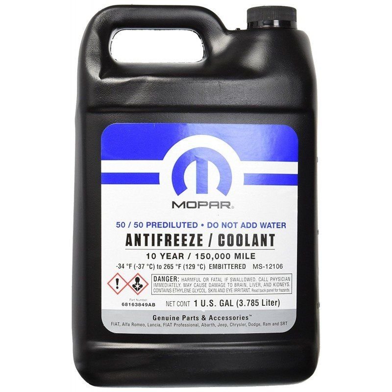

Originally Posted by tnheritage
So a 2014 take Oat, correct?
Yes, you have OAT coolant. The bottle should clearly say 10year / 150k miles. If it says 5year / 100k miles, that is the HOAT, and you don't want it. When you buy it, you might run across 50/50 premix for ~$20/gallon, but you can also buy full strength, non-dilluted. I think I paid ~$24 or $26/gallon at my local dealer for full strength. Again, the jug will clearly state if it's 50/50 prediluted. Attached is an example of the premixed stuff -
Edit - note that when opening your rad cap and looking in, it will probably look orange. The purple is an additive, and it looks different in different lighting. Unless you have had some sort of work done to your cooling system, there is no reason to believe that what is in there is anything other than OAT.
