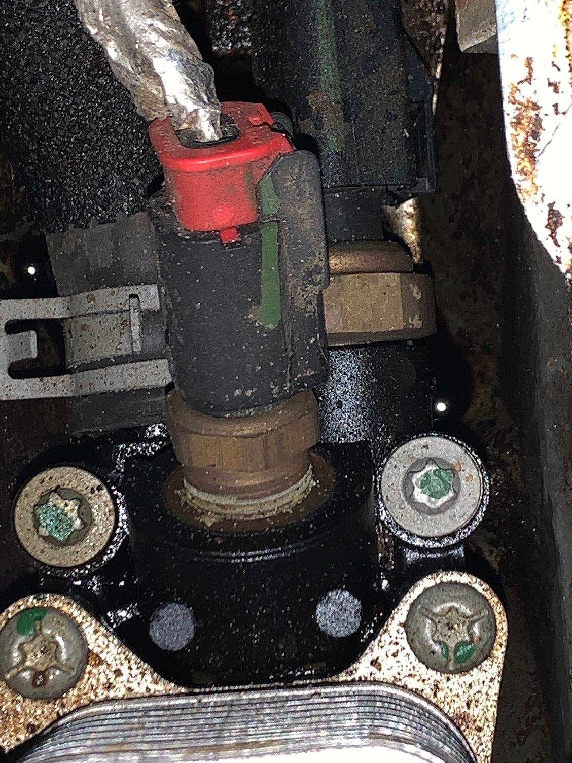

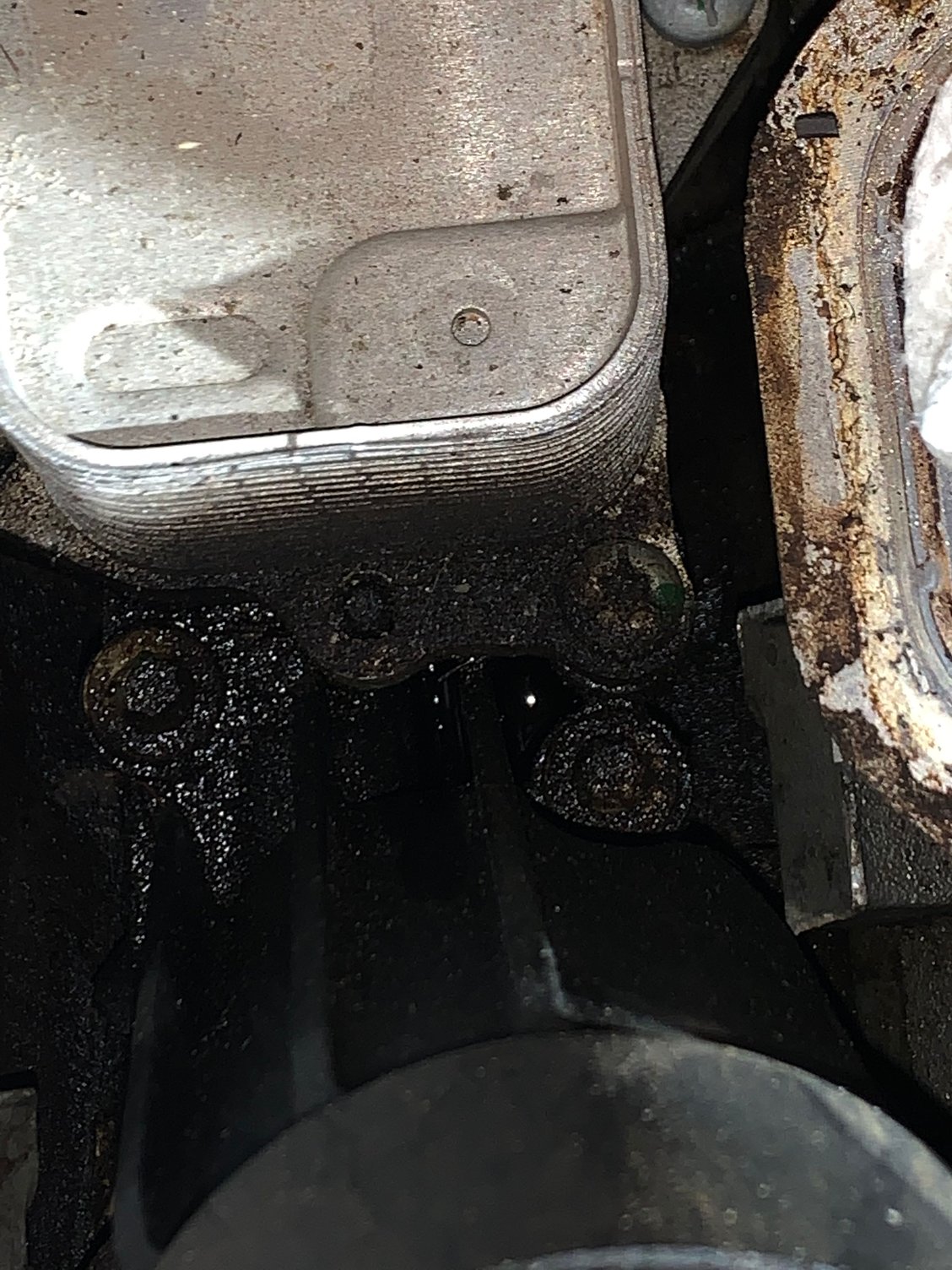

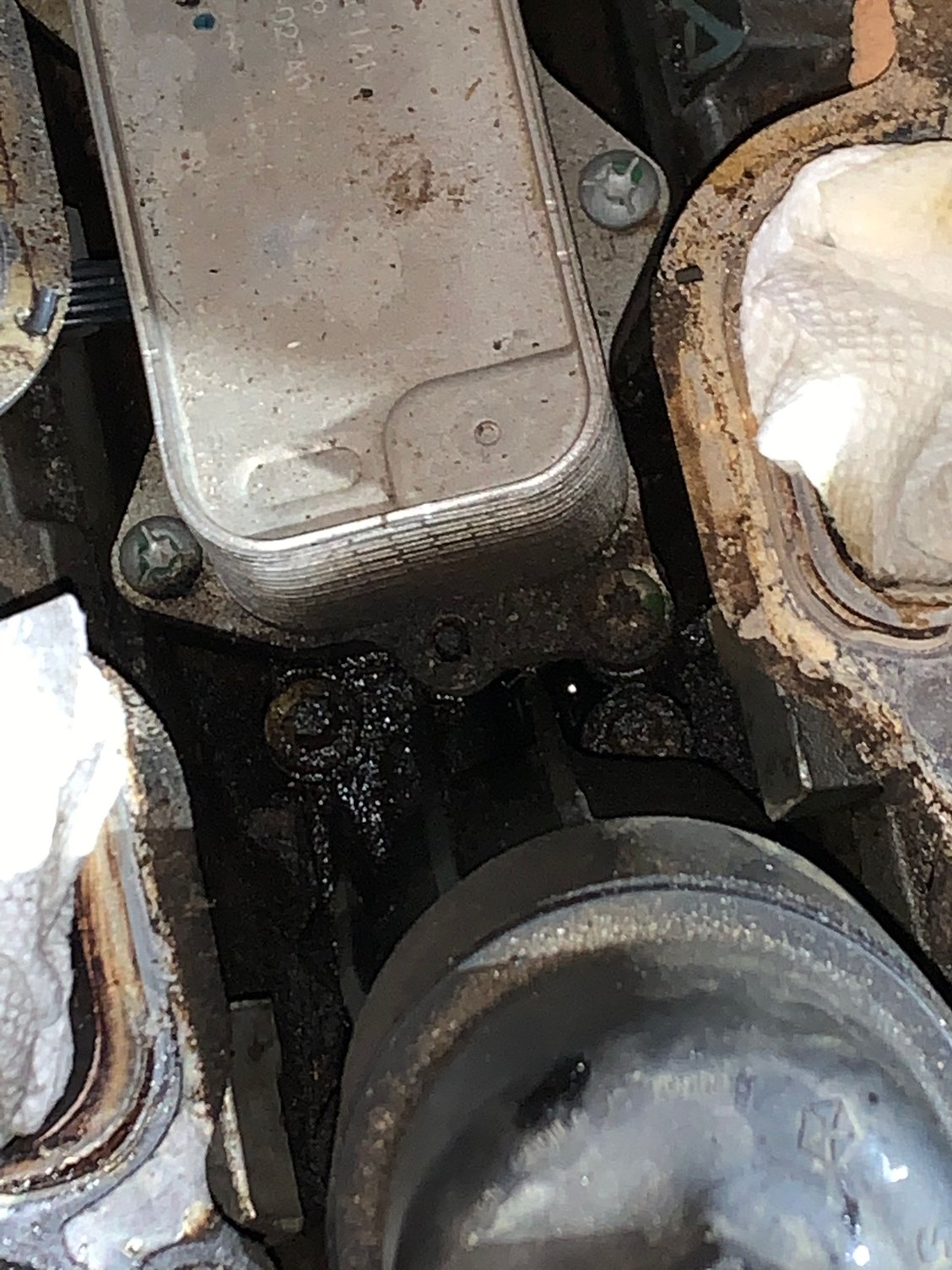

oil leak is definitely from the oil filter housing.

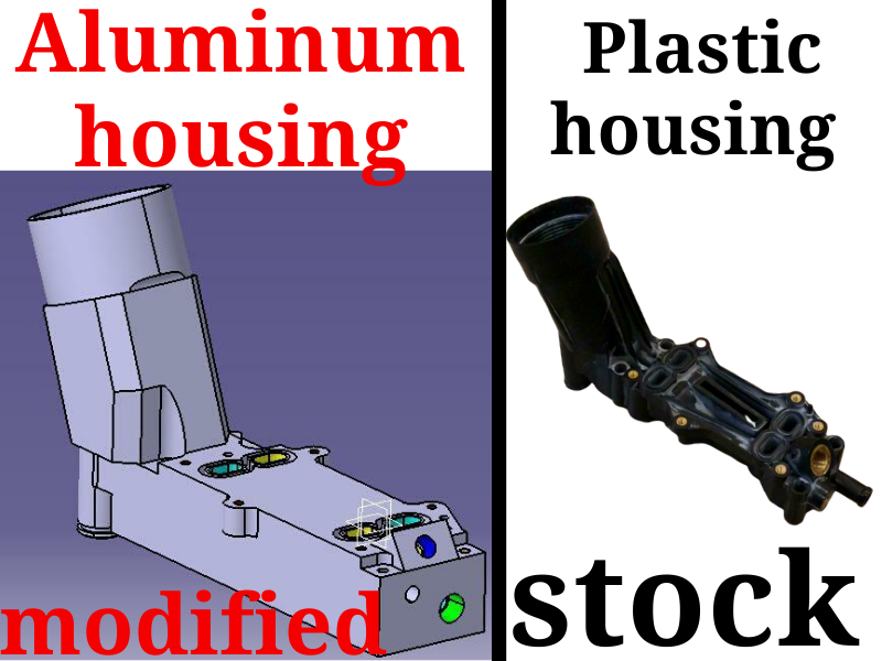

I know that there have been multiple revisions to the Mopar part, whether that has completely solved the issue I'm not sure as those who replaced the part a few years ago might not have reached the next milestone where the part fails again. This was posted in that long thread, person who posted I believe is German so it's a bit hard to follow, second last page is worth a read. As far as I know there was never an aluminum part made as a replacement.

As I very much like my car, and will continue to operate it further, I want to make aluminum detail instead of plastic one.
The housing will be manufactured of massive aluminum plate by method of milling and will be compatible to other details making knot.
Works have already been conducted and somewhere by the beginning of spring I will be able to carry out tests on the car. If tests are successful, this problem will be solved completely and for a long time.
It’s interesting to get know your opinion on my option of increase in reliability Pentastar.
