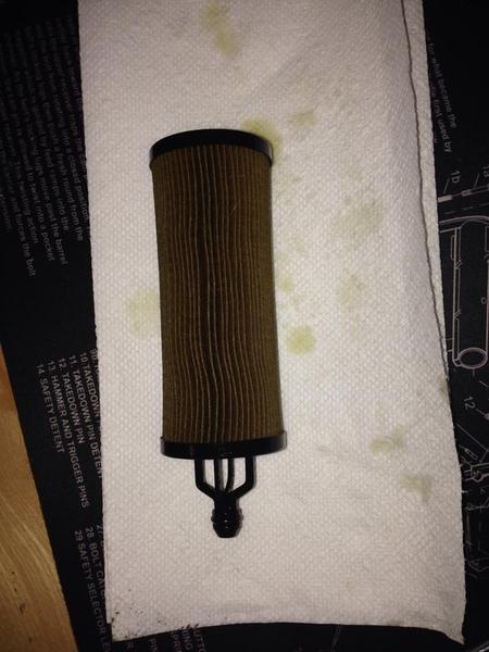

I just changed the oil in my Rubicon after I broke the engine in (I know they say it's not necessary, but it makes me feel better). I started it up and I'm now getting a low oil pressure light. After scratching my head for a while I finally googled it and they apparently changed the filter for 2014. The 2013 fits, but it's not correct. I'm thinking this is causing the issue.
None of the auto parts places in my area have the correct filter yet and all the Jeep parts departments are closed tomorrow. I need a new filter ASAP.

From what I understand, the 2013 filter doesn't have the extra piece at the bottom with the O-ring.

The Mopar MO-349 (68191349AA) was the only available option. I had to go to the dealer to get one.

pull it out, go buy some marvel mystery oil or sea foam and clean it. Soak it for a few minutes, drain and gently brush it free of debris. Rinse again with the same oil. It will be fine until you get the new one.

Napa has those. They almost gave me the wrong one earlier today.

Even if the picture referenced the wrong filter they have both. If it has to be the one with the o ring which is the same as the 2012-13 they have that one too. Wix makes those filters(which I prefer). The one you posted a picture of is a actual mopar that they carry. Let me know
