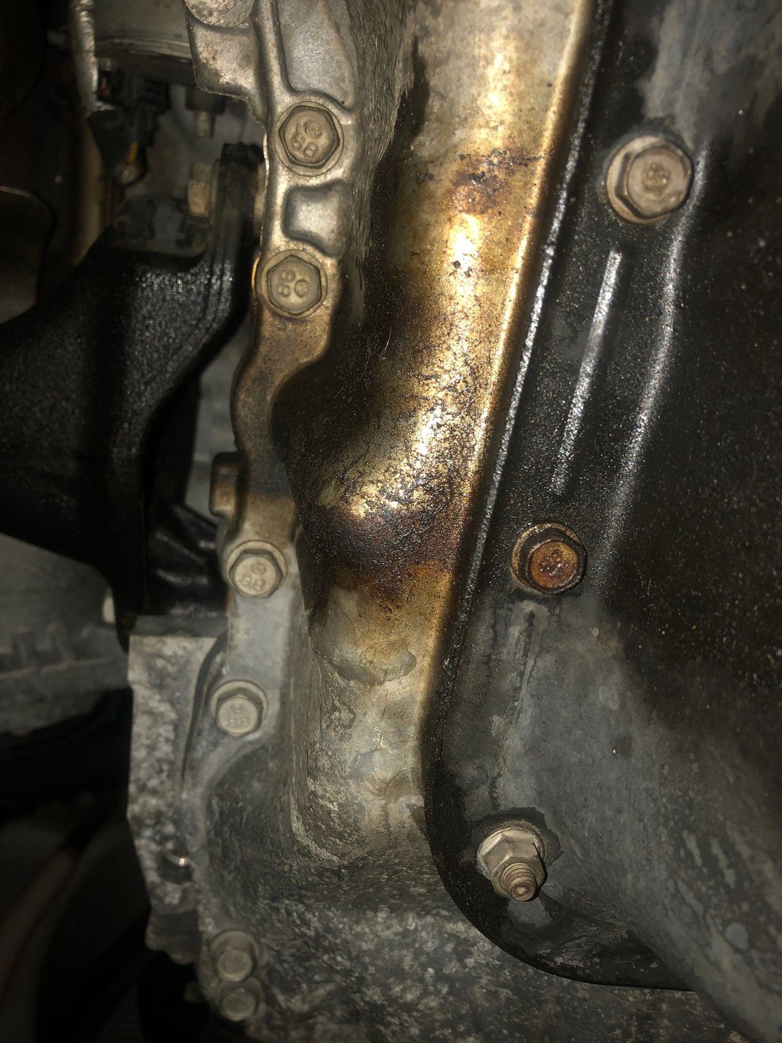

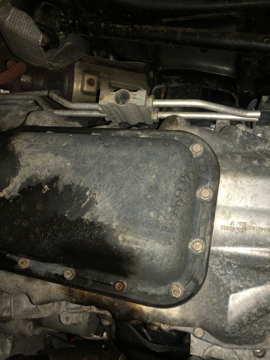

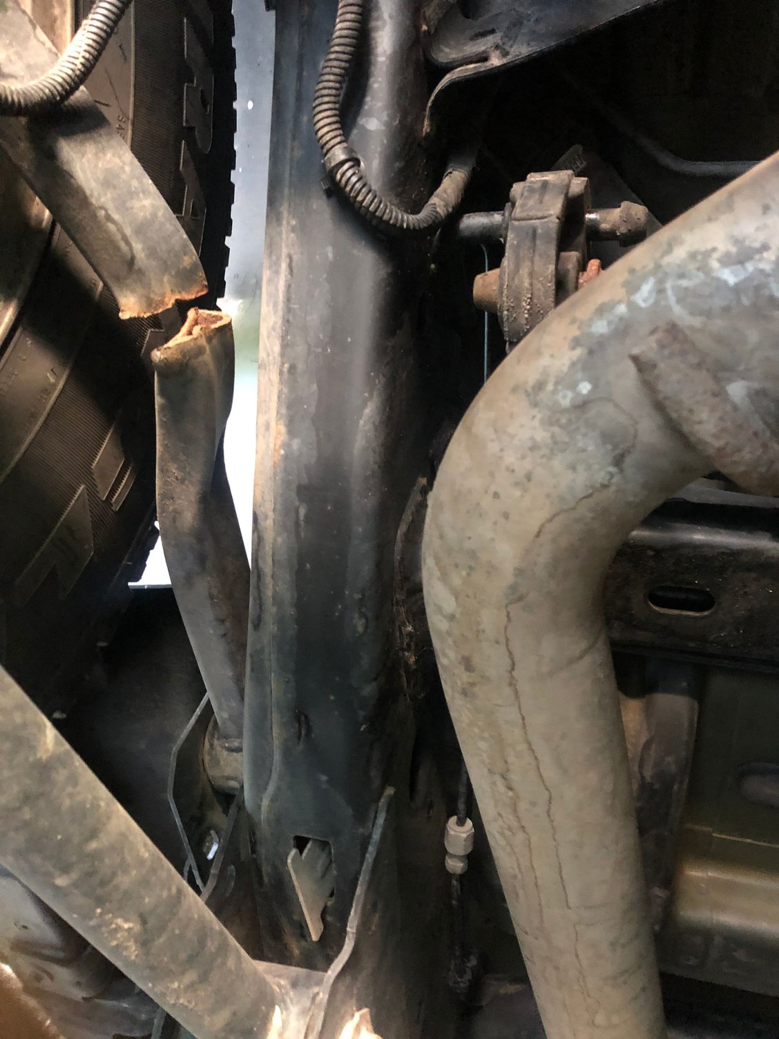

Selling JKU for my daughter and noticed two issues. One is an oil leak that looks like it comes from above the oil pan and other is a broken brace on the driver's rear undercarriage that attaches to the frame and the wheel area. I live rural and it is an hour drive to nearest repair facility. Need help in identifying broken part and ideas on where oil leak is located. Thanks,

What year is the Jeep? Many 2013-2014 have leaks up around the oil filter housing at the top side of the engine.

Ummmm, holy cow. That is a completely broken rear upper control arm. DO NOT go driving that thing till that is fixed.

That oil pattern could very well indicate the oil filter housing. It leaks in the V up top, drips down the back and eventually coats everything in oil. It's not a quick fix, but can definitely be done at home:

That UCA on the rear requires a new part. Do not weld or try to straighten. It is a critical component.
