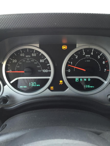

I was in park. Disengaged the E brake and then went to make a u turn. When I did it felt like the brakes were still locked.
On the dash I have ABS light and ESP lit up.
All 4 rotors are burning hot.

Superchips reads my trouble codes are the following....
1 of 3
U1418 implausible right wheel distance signal received.
C1032 right rear wheel speed sensor signal erratic performance
C1035 right rear wheel speed comparative performance.

Disconnected battery. Let it sit for about 5 minutes. Re-connected. Lights still lit on dash.
