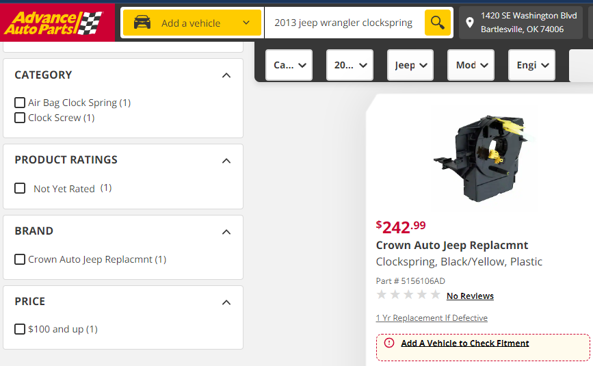

For a long time the factory clockspring was back ordered. I'm not sure the status these days, but that factory unit is $$$. I used a Crown replacement and it's been perfectly fine for a couple of years now.
I was just going to reply, 'why can I not find this anywhere?'.....nothing on Amazon. Napa, $400 lol I'll have to find a source and hope for quick shipping around this time of year.

Wow! When I bought this it was ~$135

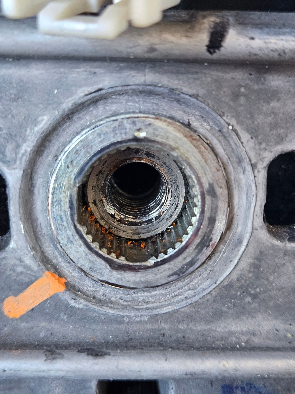

I'm fked. So I got the wheel removal kit. And the center piece ruined the threads in my steering column...Just the first few and the wheel isn't even close to being loose. How do I fix this?
I have a tap and die set but don't know the bolt thread type

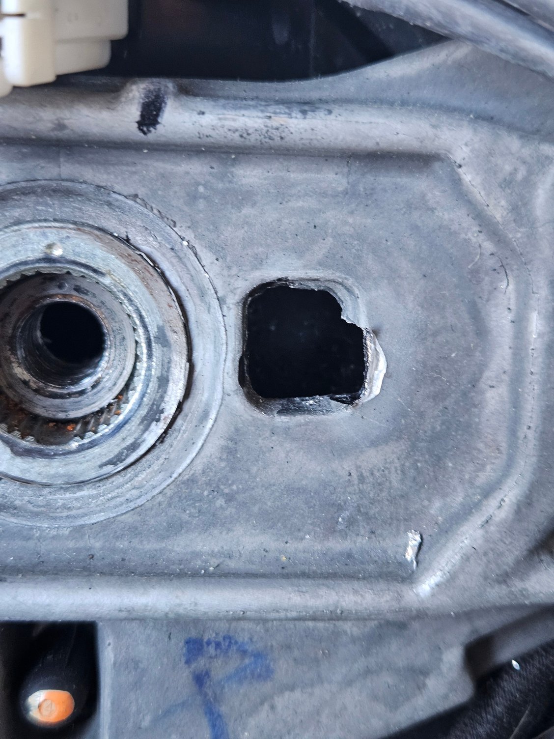

Old Dec 31, 2023 | 12:00 PM
fowlken8's Avatar
Loved
Joined: Nov 2023
Posts: 96
From: Albuquerque, NM
And now I broke the steering wheel square hole. Had it shimmed and all so it wouldn't move. This thing won't budge at all.
