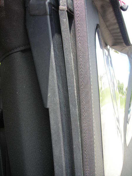

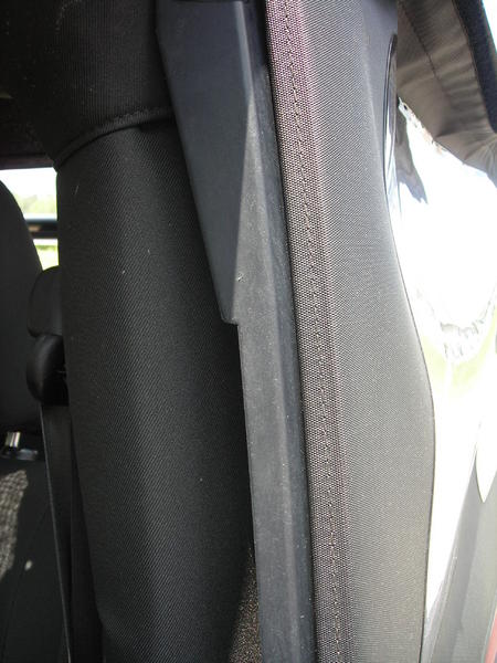

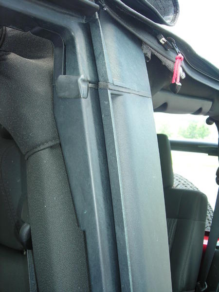

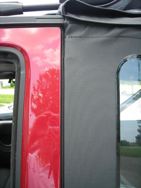

Another question, I'm not sure how the side windows are supposed to fit along the door jams? Are they supposed to tuck in to the jam area or stick out, I'm assuming there supposed to tuck in but it makes opening and closing the door somewhat odd

Originally Posted by NJ JK 11
<img src="https://www.jk-forum.com/forums/attachment.php?attachmentid=325754"/><img src="https://www.jk-forum.com/forums/attachment.php?attachmentid=325755"/><img src="https://www.jk-forum.com/forums/attachment.php?attachmentid=325756"/><img src="https://www.jk-forum.com/forums/attachment.php?attachmentid=325757"/>
Thanks for the pics
