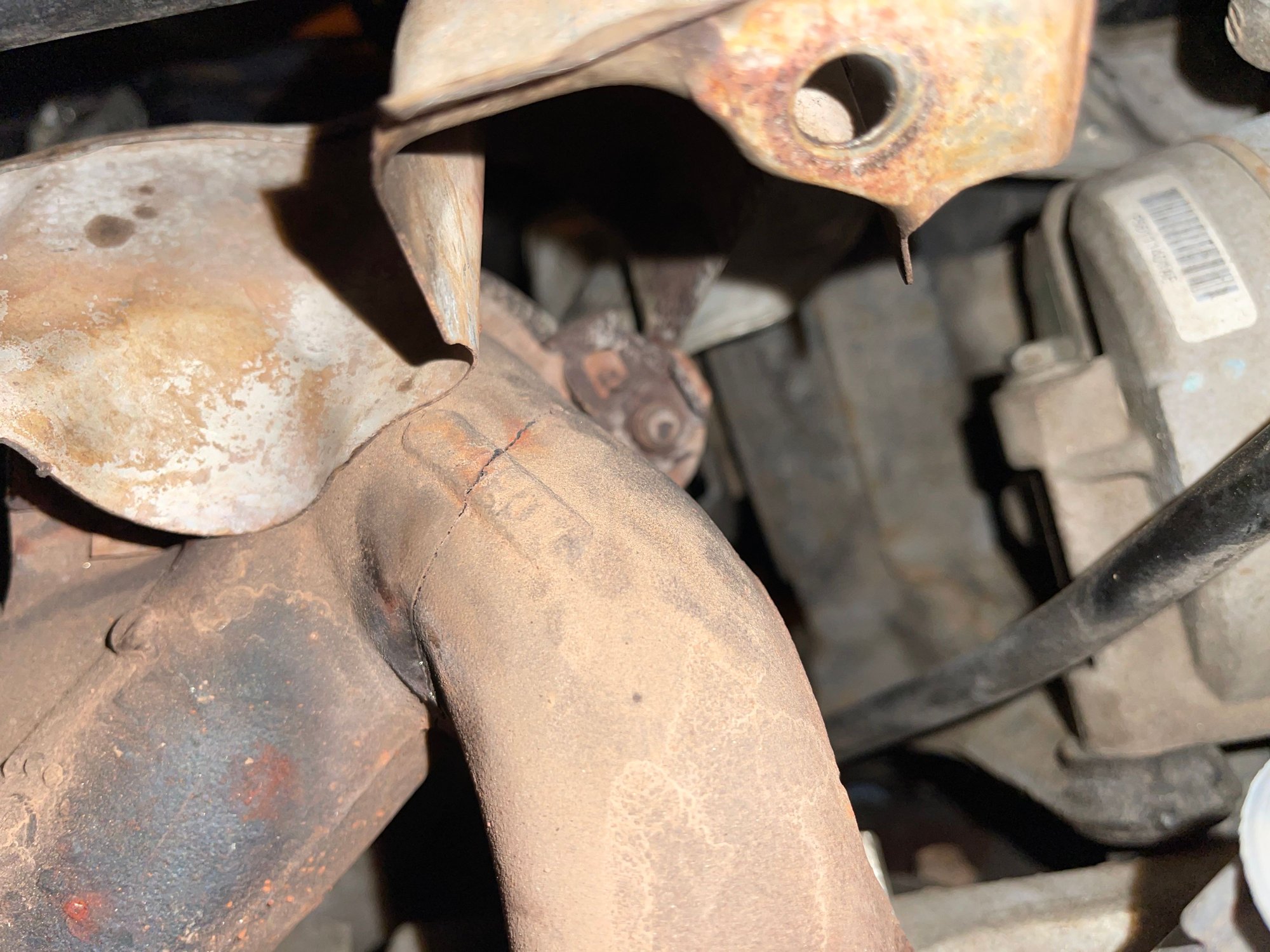

Also check if the bolts on the exhaust manifold flanges leading to the cats are loose. If they are, it will take plenty of penetrating oil or replacement to get them tight again -- the square nut holders on the top side spin pretty easy. It's a 2-bolt flange and replacing or tightening just 1 of the 2 is all that's necessary.
Edit: Sometimes you can just push each cat up and down to see there is play in the flange joint.

Sounds like exhaust to me.
I had issues with brand new manifolds getting loose on me where they meet with the exhaust system.
The bolts kept backing out,
I retorque and 100 miles later the sound returned!
And it did the same thing, sounded fine when hot, but loud when cold.
Get it fixed sooner than later since it will mess with the AFR readings, my gas mileage went to shit while it was leaking.
New manifolds are threaded, so I just added a nut on the top of the bolts to keep them from backing out again.
