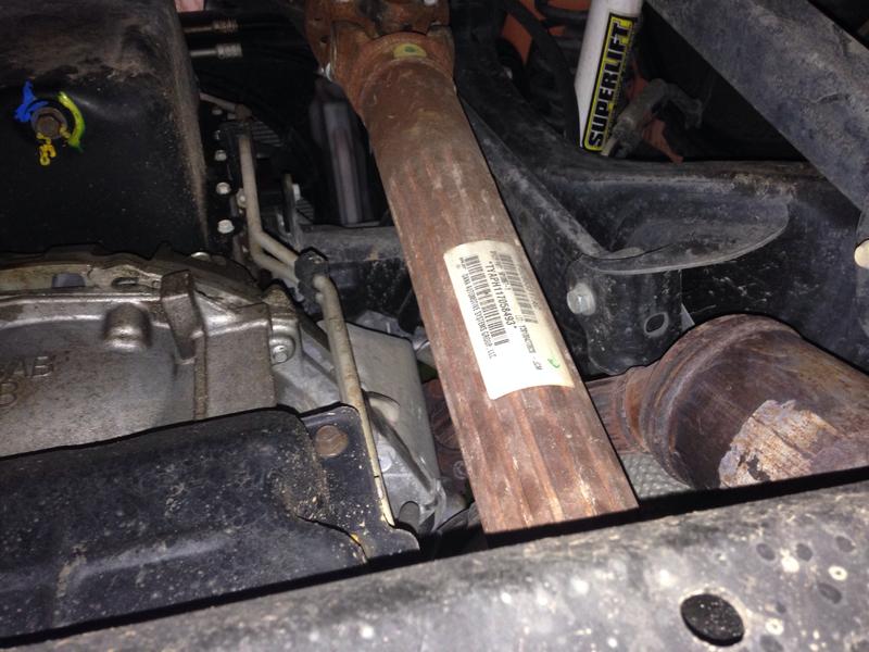

Originally Posted by Afterfrancesca
Attachment 542243
Hmm I didn't really see a black box I took a picture to maybe point me in the direction lol;/
Further back. The evaporative canister is towards the back of the Jeep. I'd take a picture of mine, but it's been moved from stock, so wouldn't help. Anyway, it's 3:10 in the morning. But, look towards the back. It has a couple vacuum lines connected to it. It's about the size of a very small shoe box (like a child's shoes might come in).
