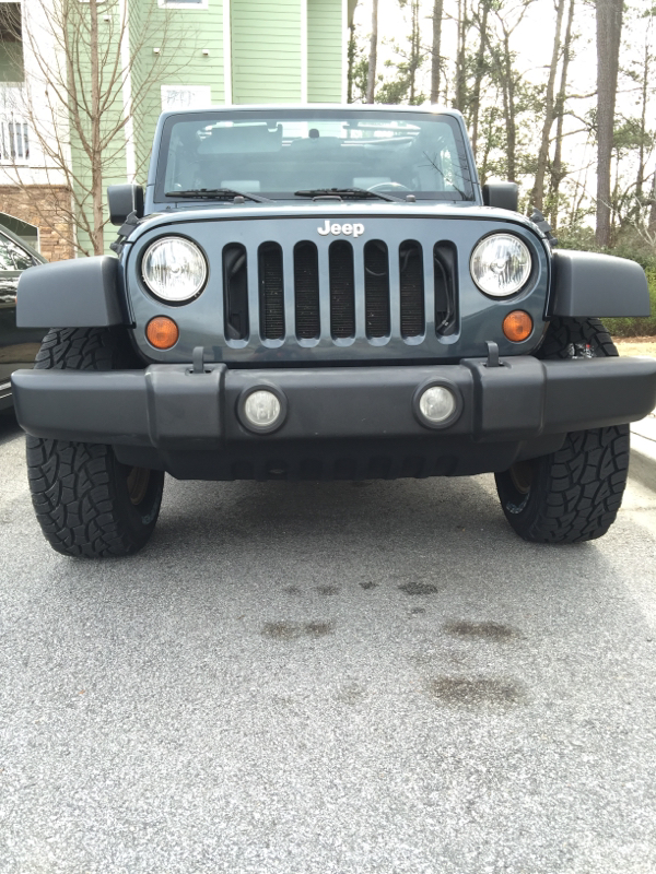

The shop didn't have BFGs like I wanted in stock like their website said they did. So I went with some Cooper A/T tires. 285s and yes they rub on sharp turns. But it sure is an improvement. Click image for larger version
