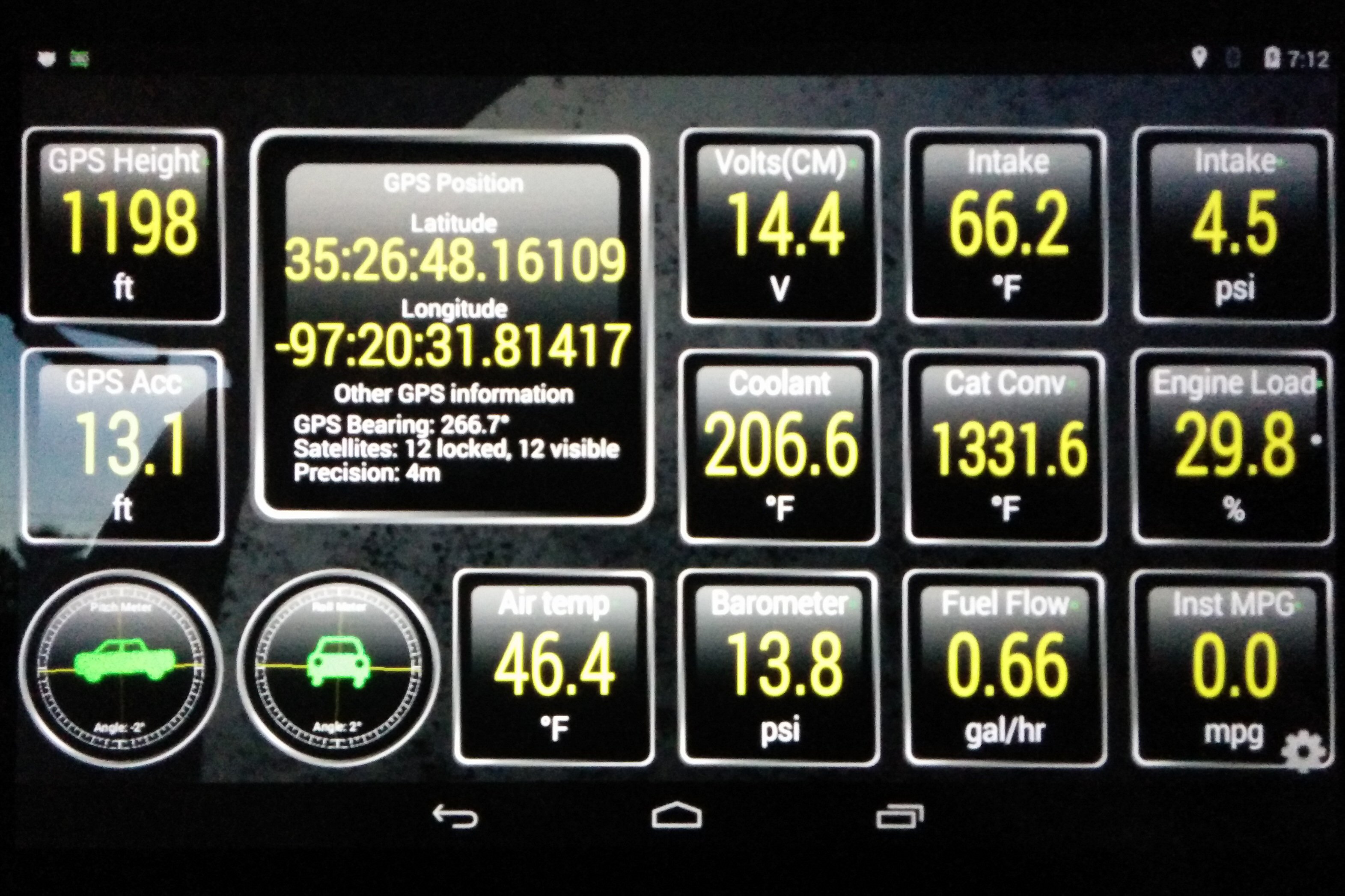

The temperature gauge on my 2007 was always unreliable. It would barely move when the temp would increase during runs across high temperature desert terrain. The Jeep does monitor the temperature, it's that gauge that's poor. Recommend that you use something like the Android app Torque Pro to monitor the actual temperature. That will also let you monitor other temperatures in the vehicle as well, including cats, intake, ambient, auto trans, etc.
