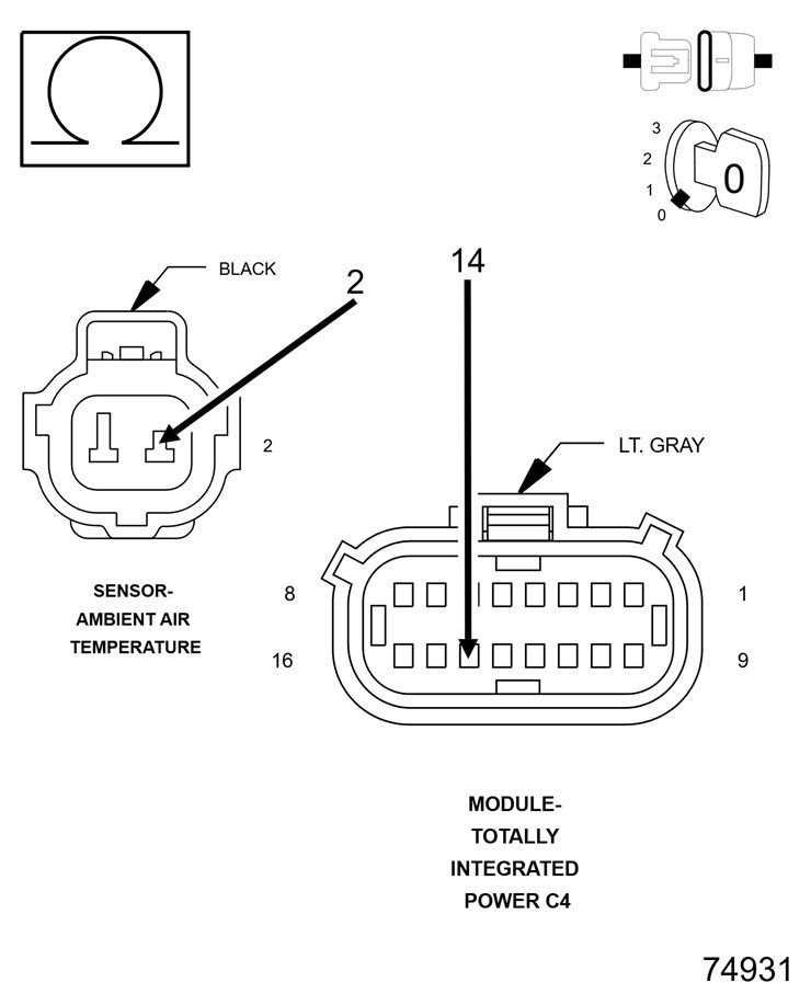

The next step would be to test the sensor wire continuity. First, with ignition off, disconnect the AAT sensor and measure chassis-side pin 2 to ground. It should read about 0 ohms.

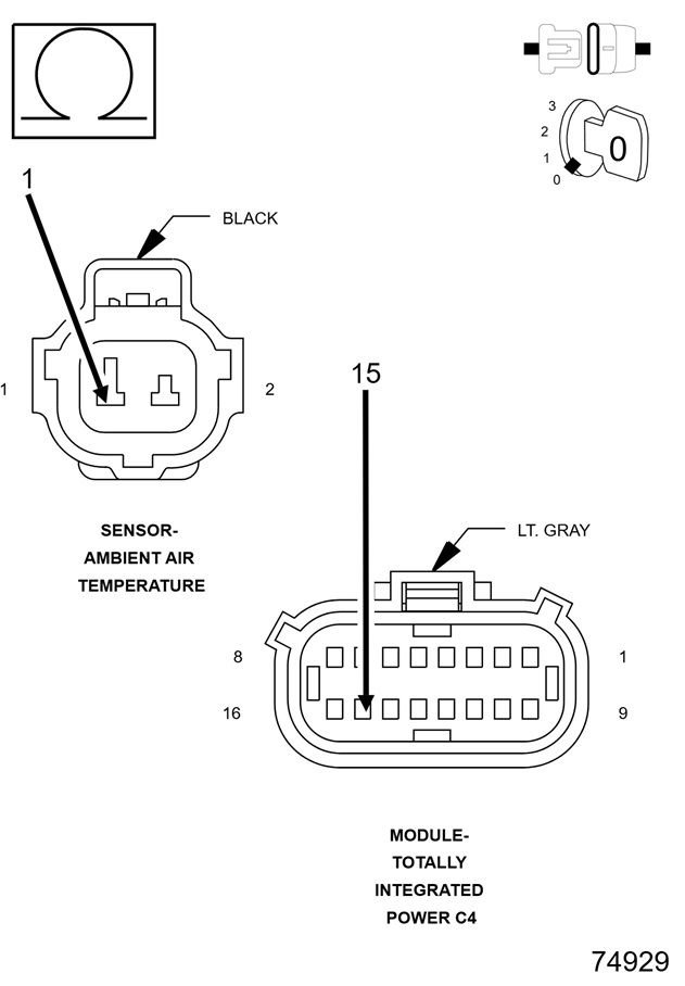

If that's good, then disconnect the C4 connector from the TIPM and check continuity between Pin 1 of the AAT sensor to Pin 15 of C4, and P2 to Pin 14. They should read about 0 ohms. If any of these fail you have an open wire.
Here's where to look:
If the wiring is good, it looks like it's a problem in the TIPM.

thanks for the diagram. I'll do what I can. I hate electronics in vehicles! I'm more of a wrench person.

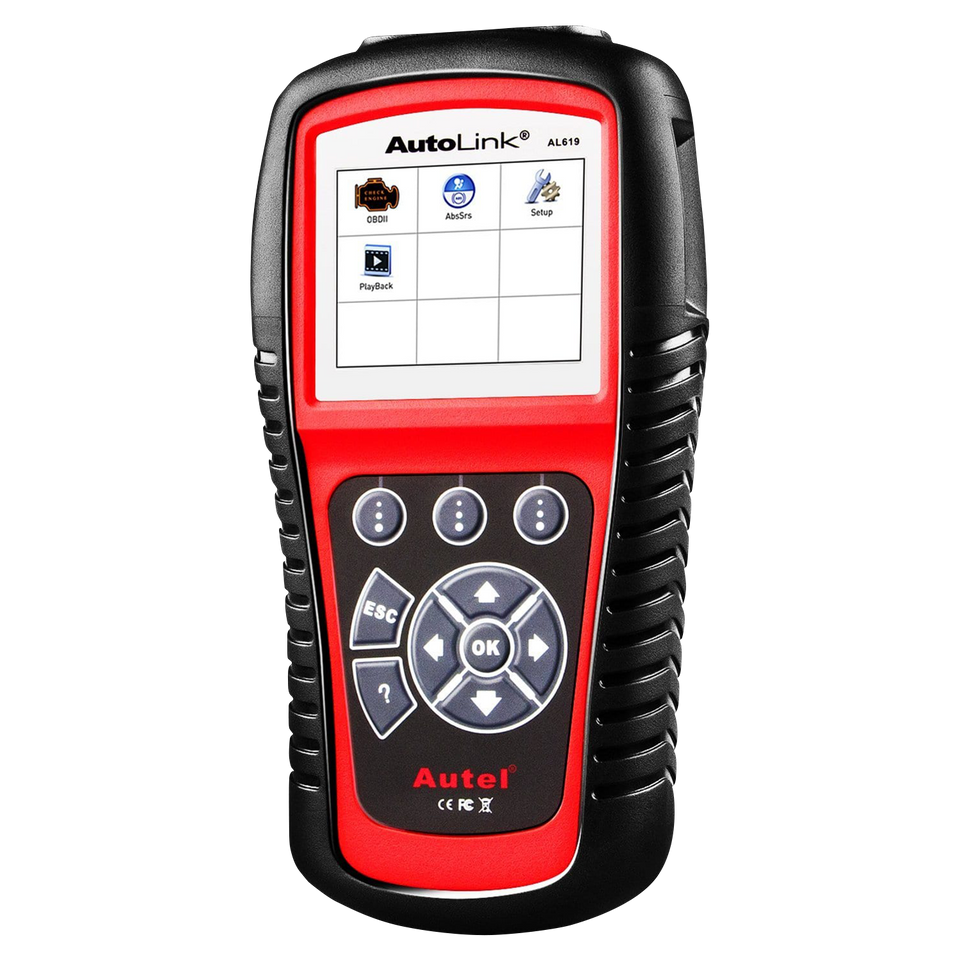

I dont have a Bluetooth smart obd2 reader, but i have a fancier plug in one that can do live data and abs/srs codes. Might that work?
Old Mar 13, 2025 | 06:53 AM
AZJeeper's Avatar
Super Moderator
Community Favorite
Joined: Sep 2007
Posts: 1,745
Likes: 87
From: Arizona
Give it a try! The hard part will be locating the AAT sensor voltage. It's a standard SAE J1979 (OBD2 protocol) PID. Depending on your unit you might just find spelled out as "Ambient Temperature" or similar. If your unit asks for a PID, try 46 (Hex) or 70 (decimal). The standard is in °C so you might not see voltage but rather a range of -40 to 215. Max cold is max voltage, around 5vdc or greater.
