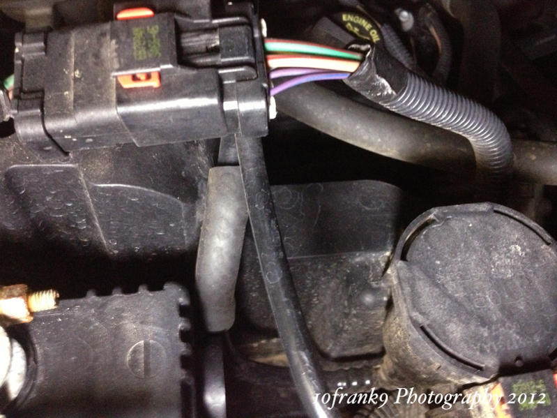

Here you can see the vacuum line that actually contacts the battery. You can see where I cut the the line and replaced it with rubber hose. The line feeds the vacuum canister.

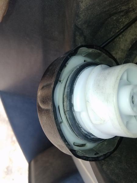

After looking at the gas cap I noticed a slight crack in the gasket. When I removed the gasket the other side was in perfect condition with no cracks so I simply removed the gasket flipped it over and put it back on. I reset the code and we'll see if that does it. Prior to checking the gas cap I inspected the lines that ran by the battery and they looked good.

I had a hole in my evap canister so I replaced the canister and reconnected the battery cable and the CEL went off. About 100 miles later the light came back on. I need to check the hose by the battery but still don't know which one it is. I looked at the picture posted above but don't know which one to check. Help would be greatly appreciated. I cannot stand the CEL!

its the line that comes off the bottom of the purge solenoid, there should be a black vacuum line that runs from under it along the engine side of the battery. would add a pic but i'm at work atm
