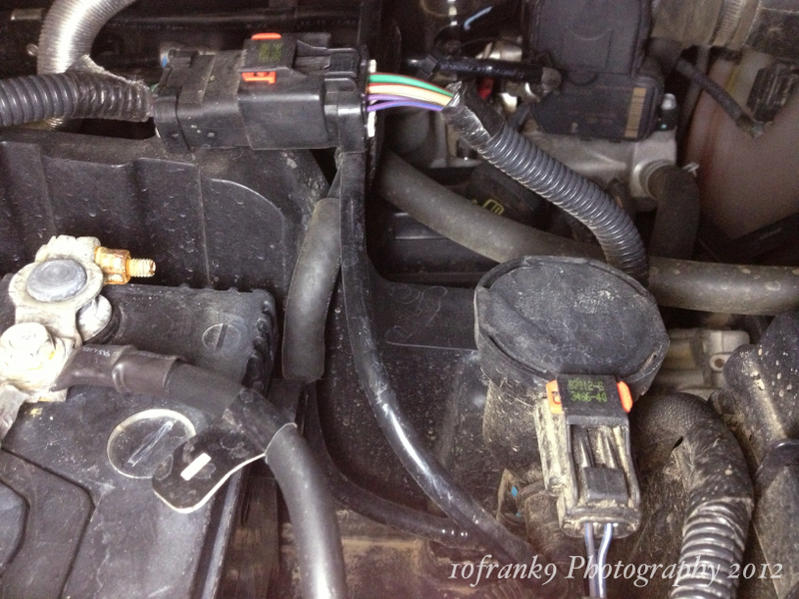

Originally Posted by hotdogging
Can anyone take a photo and point to vacuum hose is the potential culprit? I'm dealing with code now, and have checked the evap canister lines and my gas cap and they are still good.
Thanks
Just saw this and yes, I'll snap one in the morning.
Old Dec 15, 2012 | 05:52 PM
  #23
10frank9's Avatar
Posts: 782
Likes: 10
From: So Cal
Here you can see the vacuum line that actually contacts the battery. You can see where I cut the the line and replaced it with rubber hose. The line feeds the vacuum canister.

Thanks for posting the pics - I've had this code pop up twice on me in the past few weeks. Each time I've just checked the gas cap and reset the codes. Comes on again I'll be checking this out.

I had a hole in my evap canister so I replaced the canister and reconnected the battery cable and the CEL went off. About 100 miles later the light came back on. I need to check the hose by the battery but still don't know which one it is. I looked at the picture posted above but don't know which one to check. Help would be greatly appreciated. I cannot stand the CEL!

its the line that comes off the bottom of the purge solenoid, there should be a black vacuum line that runs from under it along the engine side of the battery. would add a pic but i'm at work atm
