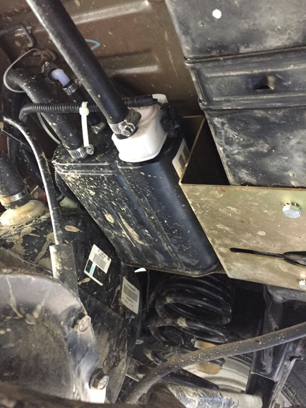

I solved mine yesterday(fingers crossed) flipped white piece over on relocated can and haven't had a CeL or gascap warning last 4 startups. FWIW I'm running a 2014 with the metalcloak relocation kit

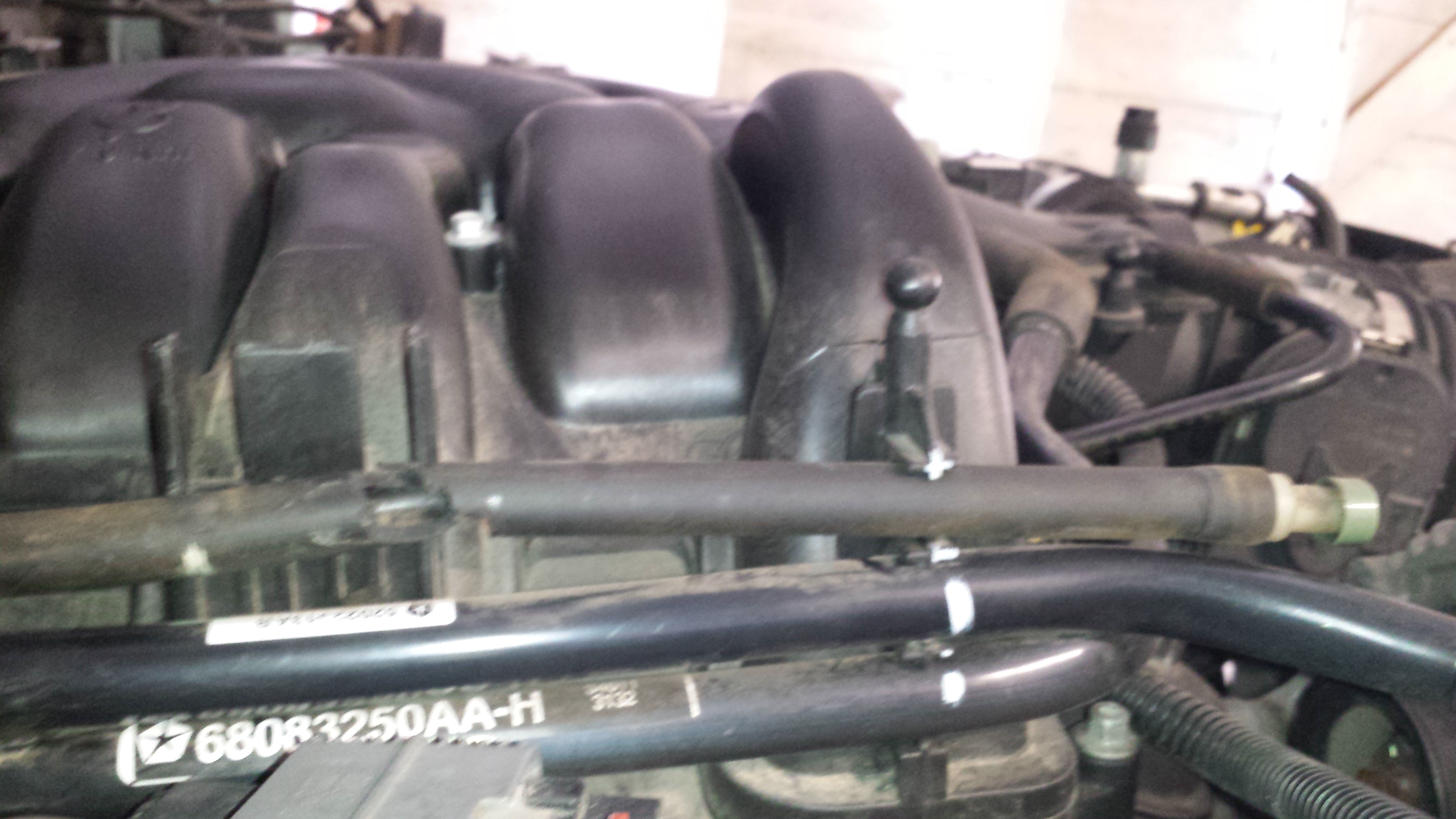

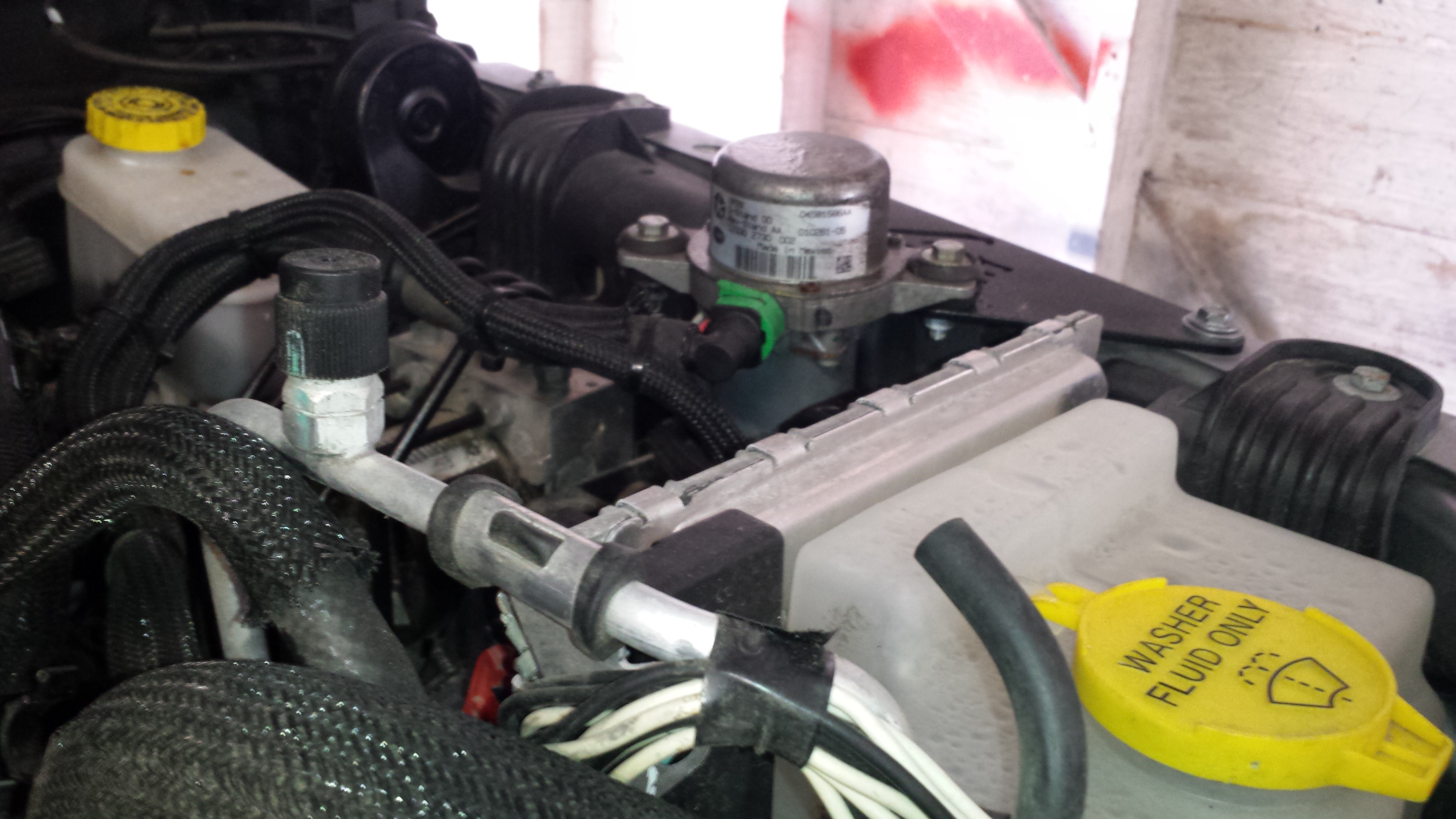

I found this hose (Stock Code 04627316AA
Transmission & Transfer Case > Case, Extension, Oil Pan, and Indicator (Dipstick)
Assemblies
Sensors, Vents And Quick Connectors) broken in half.
The other open hose I saw was from the relocated vacuum valve.
My code shows only every 5-6 months. Very frustrating. Where to go from here?
